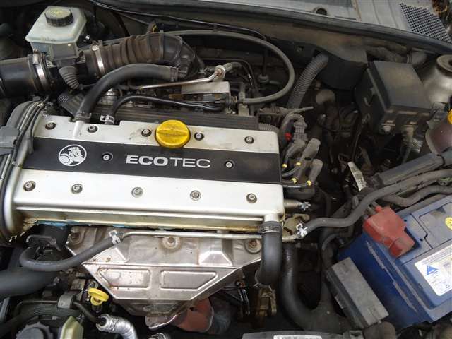

is the Vectra 2.2 engine the same basic engine ? It has 140hp and 200nM torque. Would move a street car along pretty well would think. But one would would probably need to re-co a s/h engine.
Mon Jan 07, 2013 1:04 am
2.2 would be fine but for my proposed project i will stay under two litre. You will have 2 choices here early or late :?: Late you will need throttle assy also as they are fly by wire if you intend to run ecu or swap the throttle body over to run cable. Astra/vectra look like they have a fat short input shaft yet the daewoo looks the same as rodeo :?: i dont know if the flywheel can be swapped from holden to deawoo as to rodeo either :?: the inpt shaft on a daewoo is 20.7 from memory and the rodeo is 25.5 i did a little research on this and it looks as if the two clutch plates are interchangable same od same amount of splines ect just a differant id so i can assume this can be overcome. spiggot may have to be changed. In theory daewoo flywheel,rodeo driven plate,rodeo pressure plate and throw out should work.
