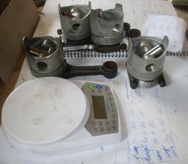

I hope they end up in order. I had the choice of two different sets of rod - one set being the earlier ones which are slightly lighter (82 g each) and therefore attractive but you will notice a setback in the first photo that occurred with these so I've opted for the heavier, stronger later model type. They have more meat around the big end bearing especially, and carry bigger bolts.
Piston-gudgeon -rod assemblies are all weighted to 1 g. Two at 1137g and two at 1136g. Piston weights varied from 337 g to 345 g which required some "fettling". Other variables were in big end caps and 1 g variation in gudgeons.

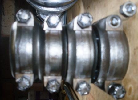

New hi-tensile main cap bolts were check fitted by the chief financier, kero-cleaner, de-greaser, go-fer and part time casual would-be engineer.

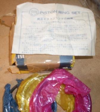

Piston rings came complete with instructions - Perhaps one of our Japanese friends who visit the site can help?

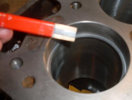

End gaps checked out beautifully -13 thou for no 1 ring and 10 thou for number 2 without any filing required. The hi tech depth gauge for locating them squarely in the bores took ages to manufacture!!

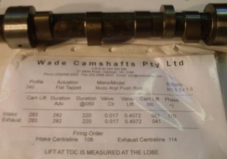

The guys at Wade Cams are very helpful. This one’s profile is designed more for massive (?) torque from 35000 rpm upwards rather than for brute HP/speed. Of course they’re good – they originated in Tassie many years ago (but are not related!!).

Not only the cam grinder but but everything else in the motor would want to be good - at 35ooo rpm's . I think it may have been an Oops!
