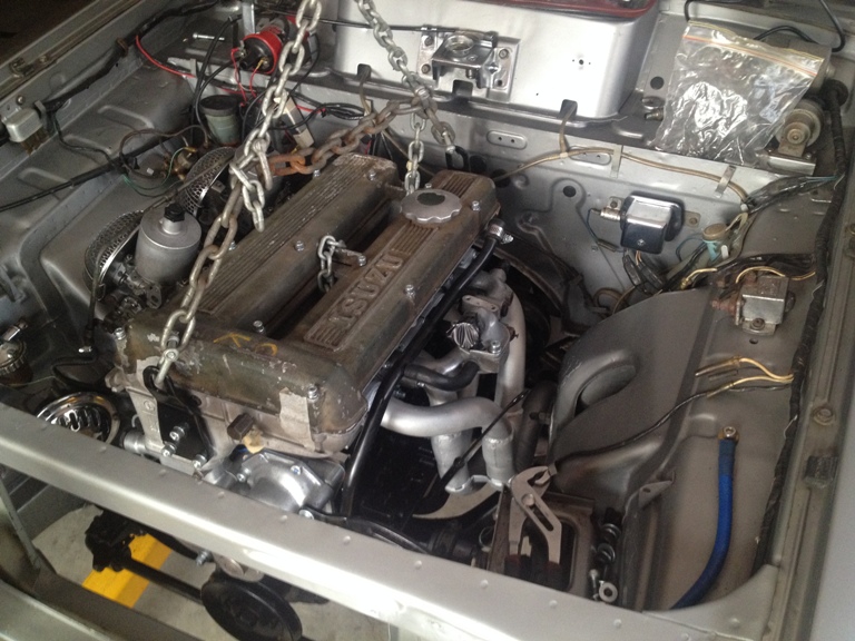

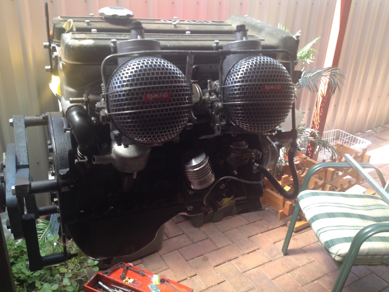

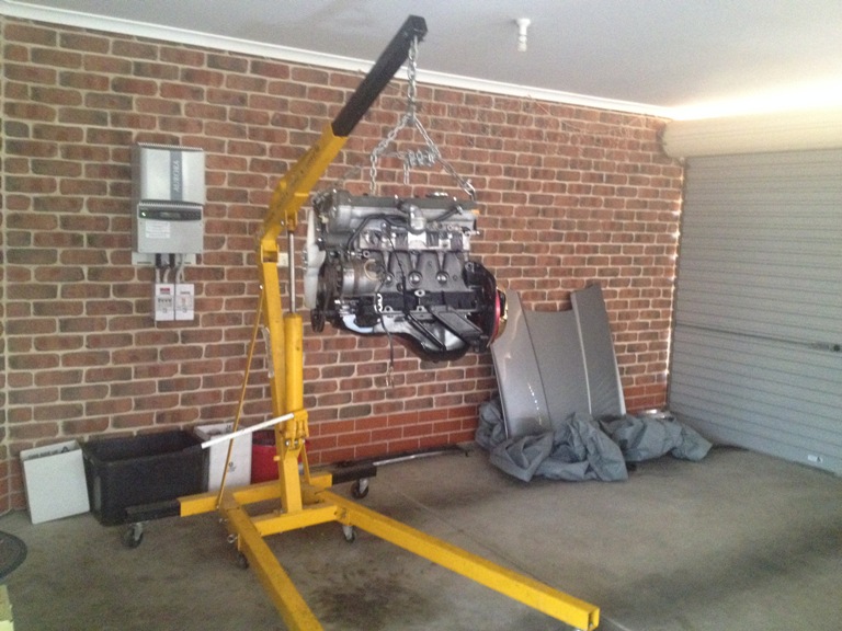

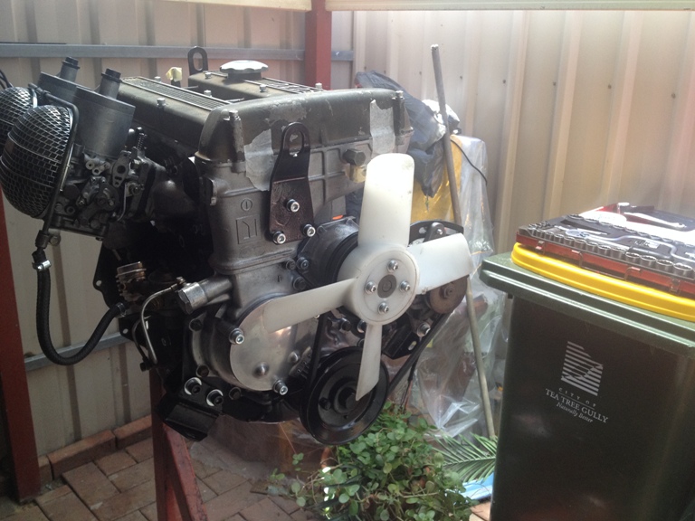

I has been ages but now I have the urge to get my car back on the road for the Summer Cruising Season.
The motor had blown the Head Gasket which started the pull down.
Got the motor machined, balanced, ported, polished.
Here's some pics

The Joys of trying to work out of a carport.

On My Motor which is the g180w Blue Top (rocker cover being painted hence the Green Top )
it is different to the early ones with the breather box in the distributor hole
Orph is correct as mine had the welch plug in the distributor hole, it has a pvc valve at the back of the head which originally went to the plenum in the fuel injection and also had one in the front of the head which T'd into the air cleaner tube
I have chosen to knock out the plug and fit the breather box
At the front right there is a small tube in the sump that is the oil return point
Hope this helps
Cheers Flying
