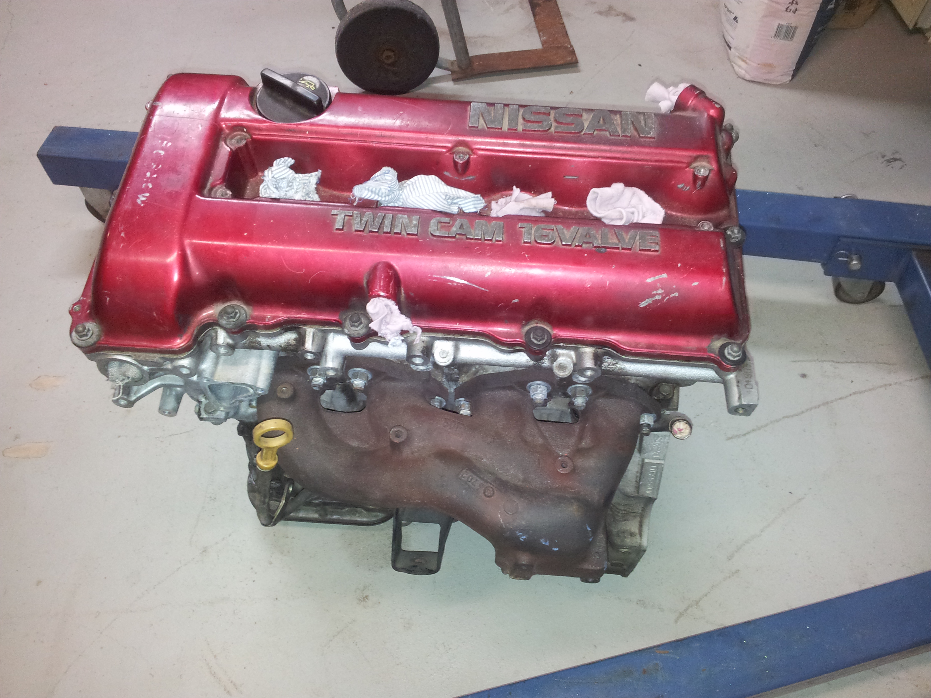

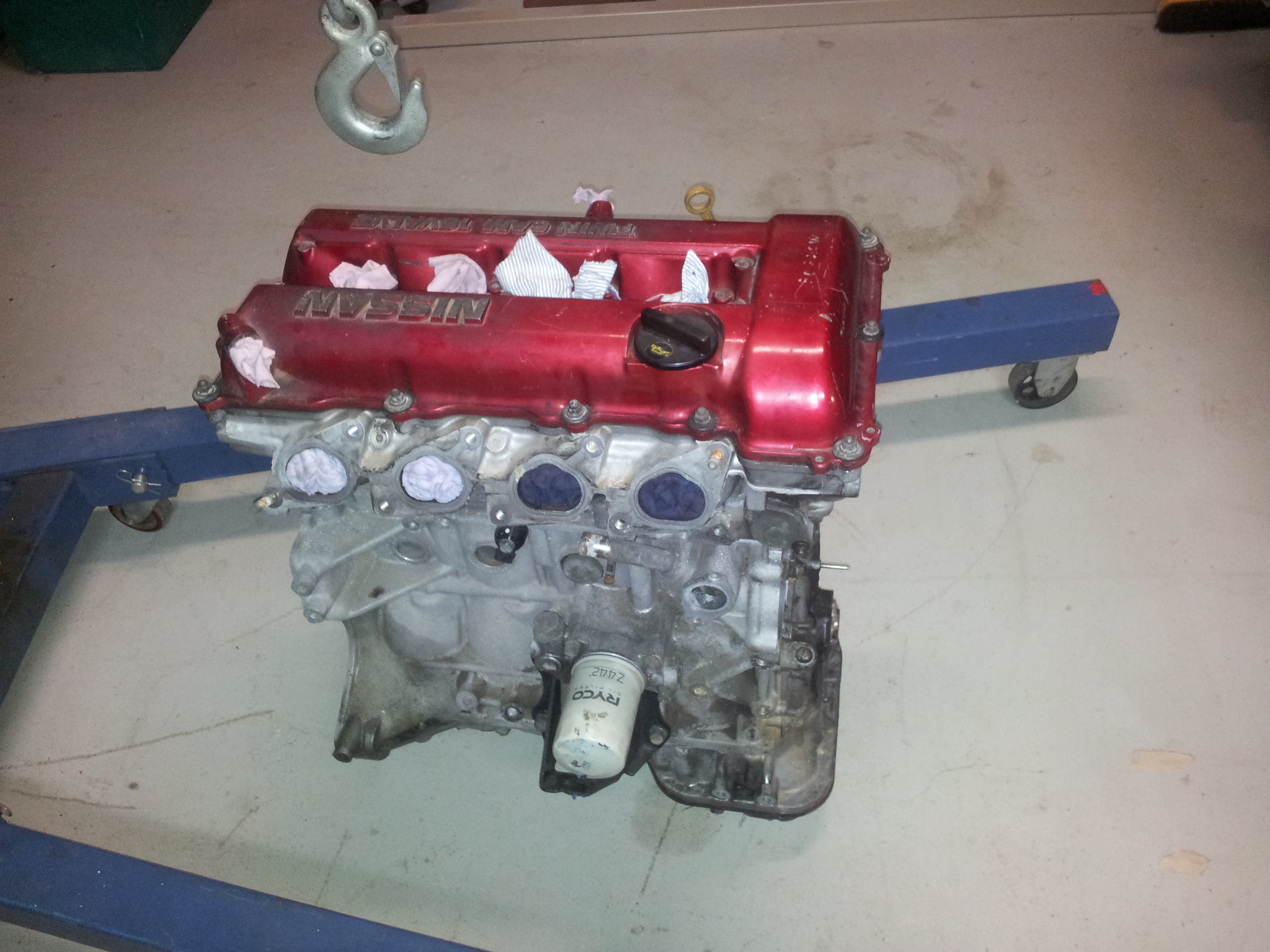

I am finally getting a GT thanks to a couple of members on the this forum, so in a couple of weeks I will be a new owner of a GT Project.
Here is a pic of the new engine which will be the basis of the project as the GT is not complete at all so I have free rain to do as I please, so please don't crucify me too much wavering away from an original car.
I will keep you informed as the project progresses.

:o that looks like fun
Tue Apr 19, 2016 4:02 am
especially the Sump clearance.
Many years back I put a DOHC Toyota (gasp) 2TG, bored to 1750cc, motor and 5 speed into a GT.... the white GT that was mine and been around a little bit since departing from Vic. ..Vic, QLD, SA, back to Vic
In those early days getting an Isuzu DOHC was a dream but later it did come about. The toyota had the same problem and although I did a lot of mods to the sump, the oil pickup was a big problem.
Perhaps there is some mix and match available though for the Nissan, to move the pickup rearwards?
Look forward to seeing the GT project here.

I have a question, does anyone know what the front and rear track measurements are from drum to drum or disc to disc. Reason being to fit the SR20DET is to try and fit a Gemini front end and a Pulsar GTIR rear end but need to know the track measurements to also assist with minimal sump conversion and handle the increased horse power.

Is the motor from a GTiR also? I had one back in 90's and a great engine, hearing those 4 throttle bodies suck air is Music ! The lighter Bellett should go even harder.
Tue Apr 19, 2016 11:20 pm
Posts: 88
Glenn, the engine is the same but rear wheel drive not front wheel drive as fitted to a GTIR so a good match. The only concern is the GTIR is mainly a front wheel drive, I am investigating if the stock diff can handle the power directly rather than the split drive of a standard GTIR. Will keep everyone informed.
Anyone know the track measurements?
I would think the GTiR rear would be fine. After all these cars were rallied with huge power increases and I imagine, mods also the front rear drive bias.
I think only the GTiR engine had the four throttle bodies though ?

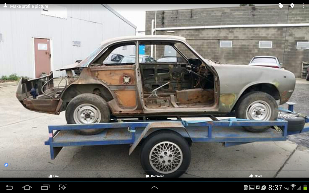

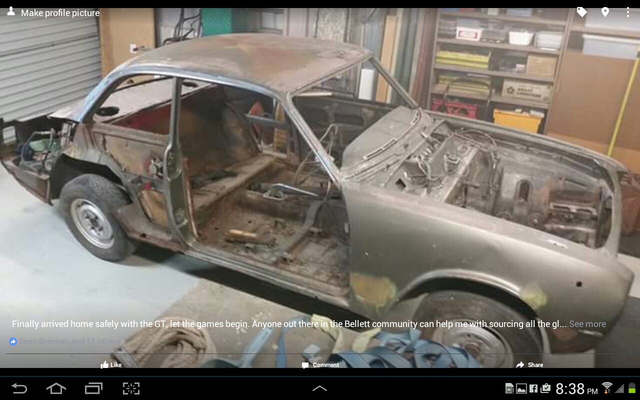

Finally picked up the GT shell so the fun starts. I just need the quarters now to get it looking like a GT again. A big thanks to OZ & Craig.
If anyone can help with glass for the whole car as you can see there is none. I have been searching on Yahoo Japan and have found glass but not sure how successful it would be to ship home.
Pick up my gearbox on Saturday so will post once I have the engine sitting in the bay to see what issues will arise.

Tue May 17, 2016 11:33 am
Just to be clear, which glass do you need?
front rear screens
rear 1/4 side glass
door widow glass
door quarters glass
missing rh door?
