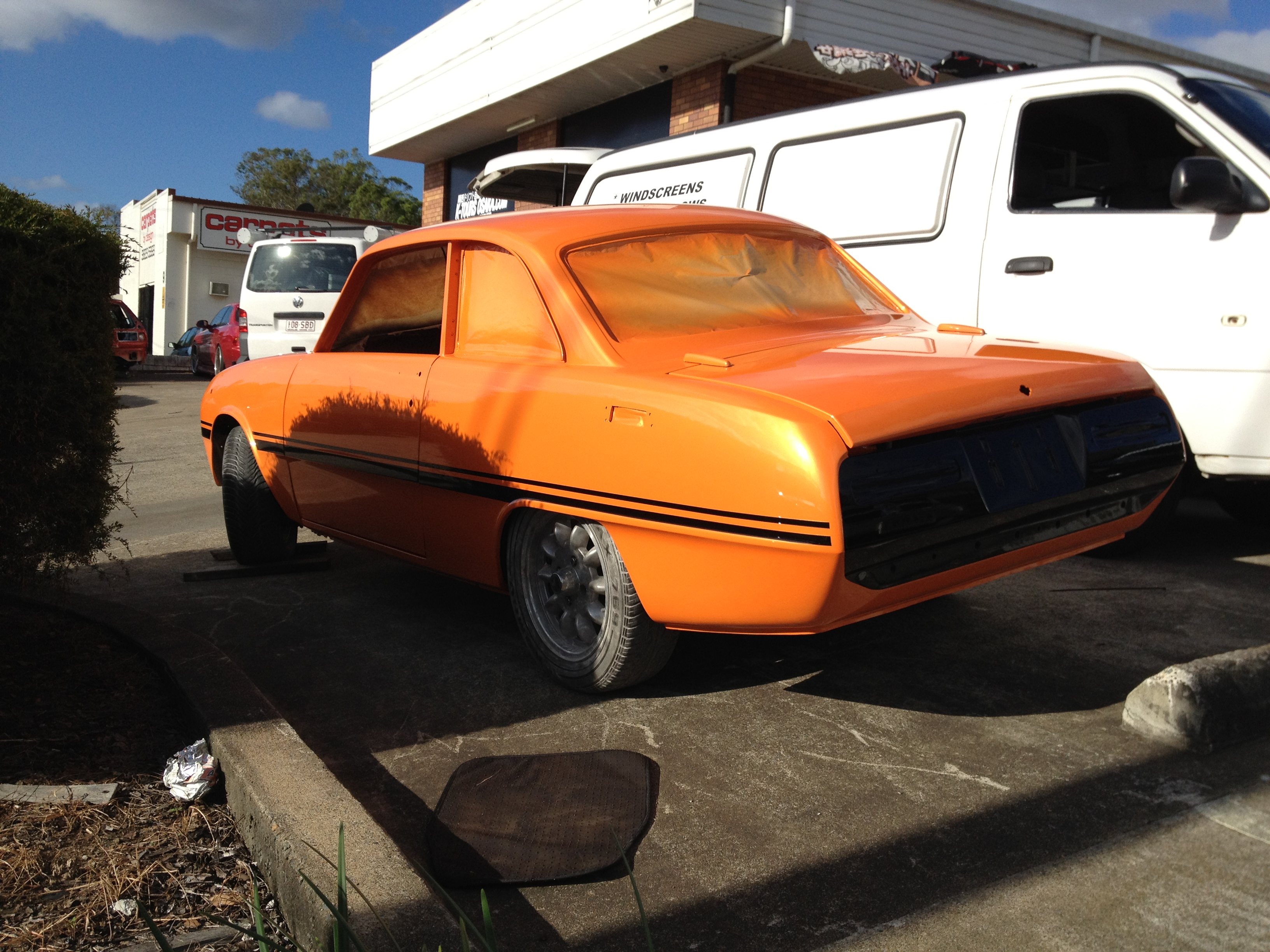

finally after 4 hard years of work the bellett has finally been painted up...and god it looks perfect! Now just to put it all back together over the next 4 years.

Is there a touch of Gold pearl in that paint?
Usually a photo never does a paint job true justice but that colour looks sensational, like its glowing.
Mon Mar 12, 2012 10:45 am
Posts: 194
Location: Brisbane
Car(s): 1968 Bellett GT
its lamborghini orange it has 8 layers of pearl through it..and yeah the photos dont do it justice its super bright, im kinda glad the bonnet is black or else i would nee to drive with super dark sunnies on all the time. it still has to be cut and polished yet so should be even shinier!

Looks great, did you use 2 pak paint or acrylic ?
Mon Mar 12, 2012 9:29 pm
Posts: 194
Location: Brisbane
Very expensive 2k with 5 layers of high solid clear
