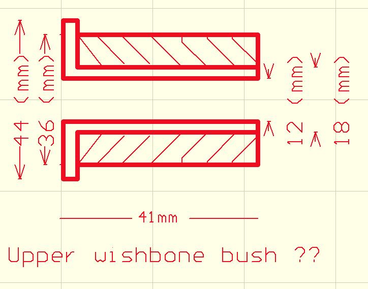

is this how your measurements come out (upper only)
[angle lines are the bush material itself]
later edit: changed picture

67GT
- Posts: 348
- Joined: Sun Jun 14, 2009 8:44 am
- Car(s): 1967 bellett gt, wasp trayback , 2018 d-max 4x4 dual cab LSU, 2016 Focus, 1996 GQ Patrol
- Location: central coast
Re: Suspension bushes
Your top and bottom red lines don't exist along the length of the bush, just across one end, but otherwise looks good.
yes, i realised that after posting the drawing67GT wrote:Your top and bottom red lines don't exist along the length of the bush, just across one end, but otherwise looks good.
are there 2 per pivot?
67GT
- Posts: 348
Ok revised drawing looks good. Two bushes per arm.
