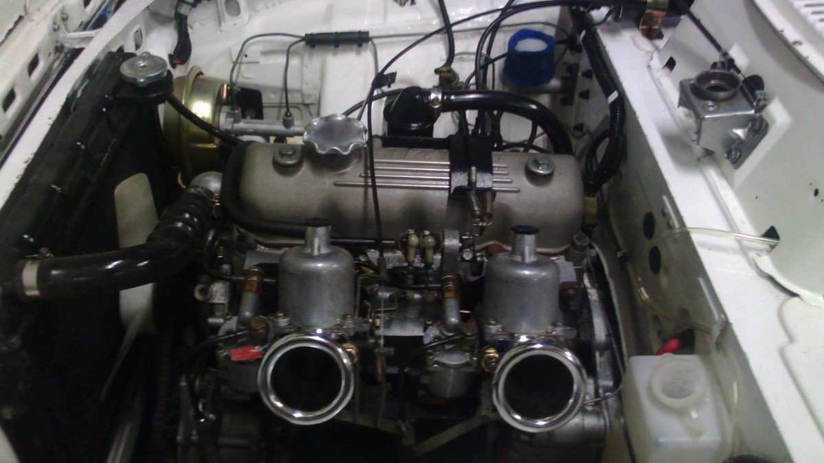

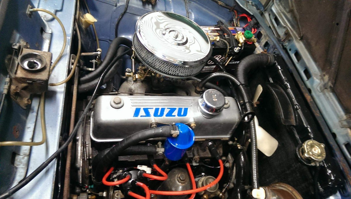

11885767_10200979935658626_75357380696336867_o (1).jpg [ 251.94 KiB | Viewed 64442 times ]
Gemini fans.
Any rear wheel drive 1975 - 1984 TX - TG Gemini will have one. Front wheel drive RB Gemini is different.
Rodeo an Jackaroo is different again, but will just fit with some fiddling. Best off to use the more common Gemini one.
