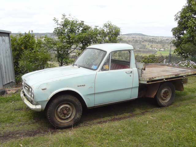

File comment: The Wasp

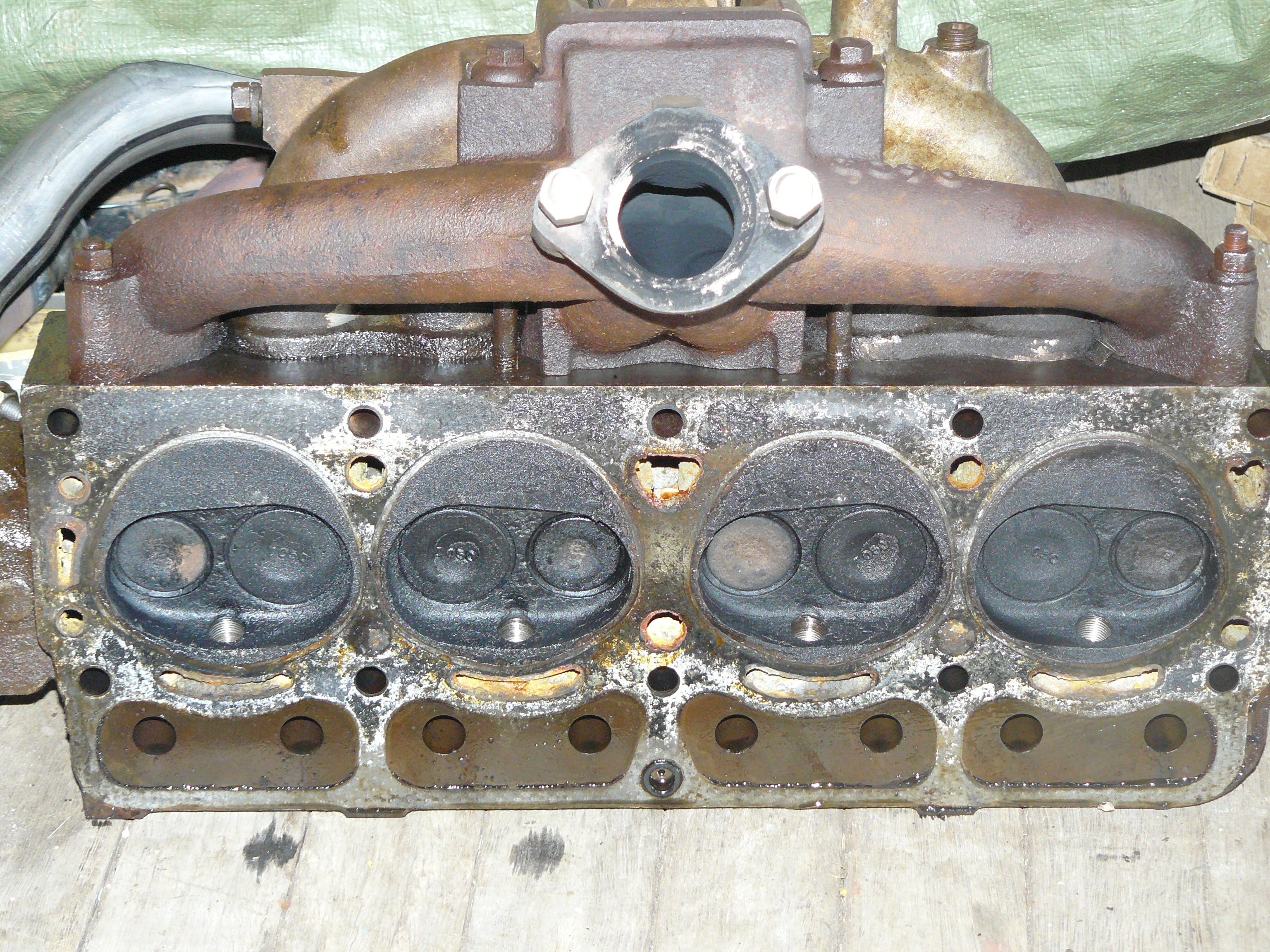

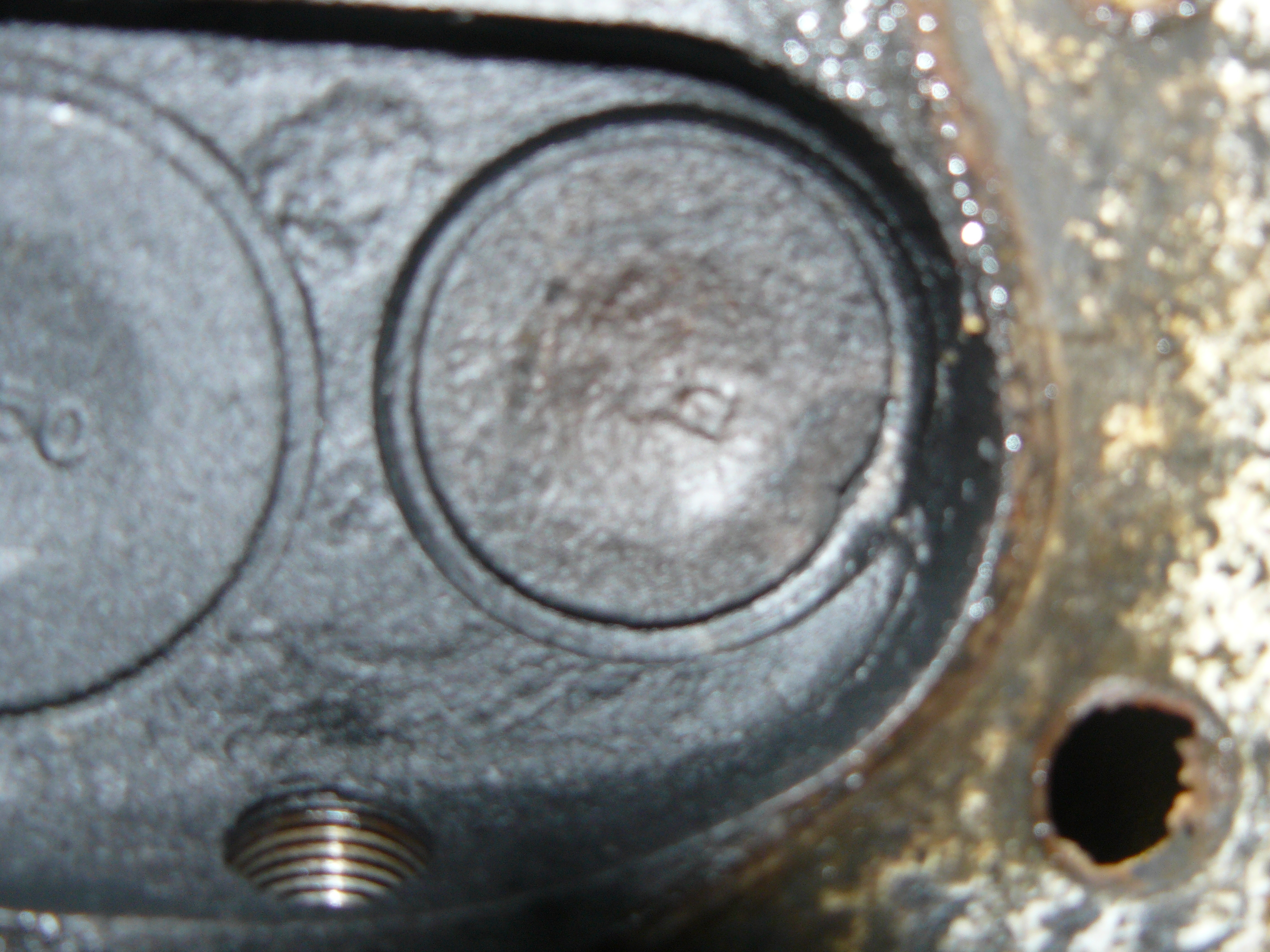

File comment: 4th cylinder exaust valve is cracked
File comment: 4th cylinder exaust valve blown
File comment: the head at last
Tue Sep 11, 2012 11:57 am
she looks pretty tidy. nice Ute.
keep those photos coming please...
Tue Sep 11, 2012 12:26 pm
Nice Wasp..........
Tue Sep 11, 2012 10:02 pm
Your Wasp looks pretty good, looking forward to many more future pics. :D
