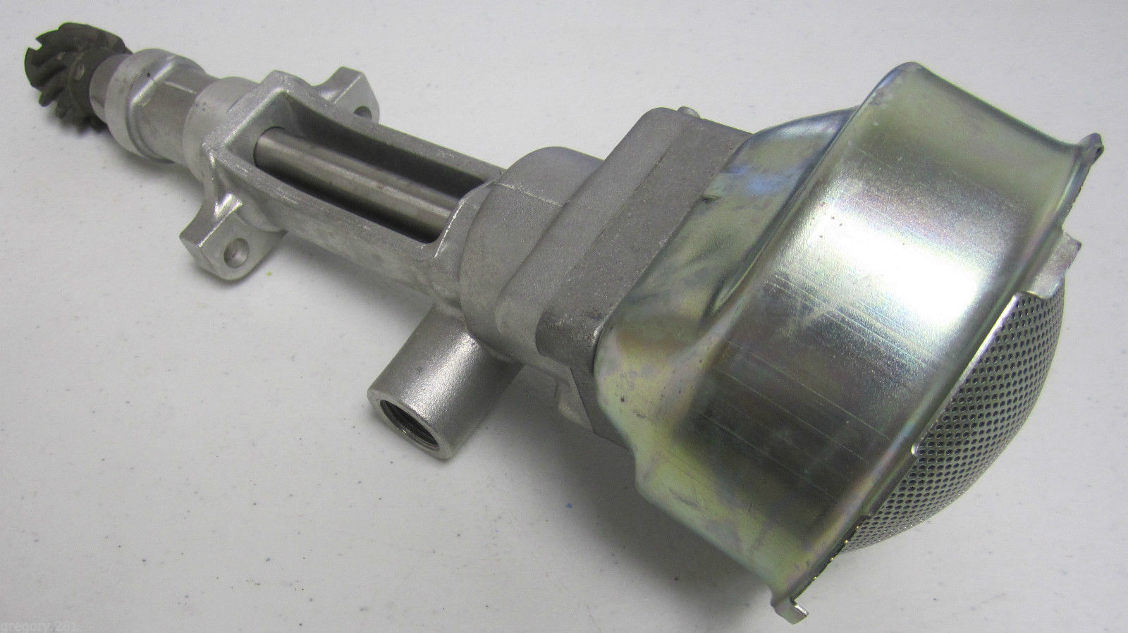

Hey Everyone,
I have found an Oil Pump (Sealed Power TRW 224-43384 22443384 50138 Oil Pump Fits 1975 Chevrolet Luv).
I am wondering if this fits the G150 as it is spot on the same in the photos as my oil pump I have now. DOES ANYONE HAVE THE CORRECT PART NUMBER PLEASE??

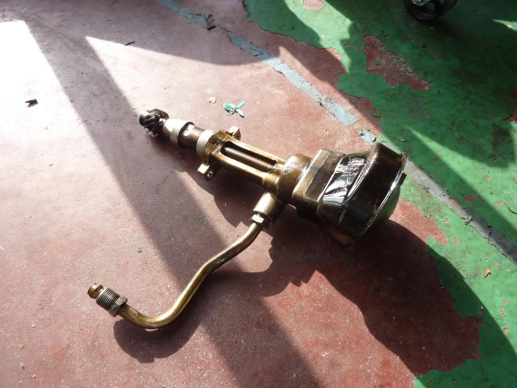

Here is my oil pump I have:

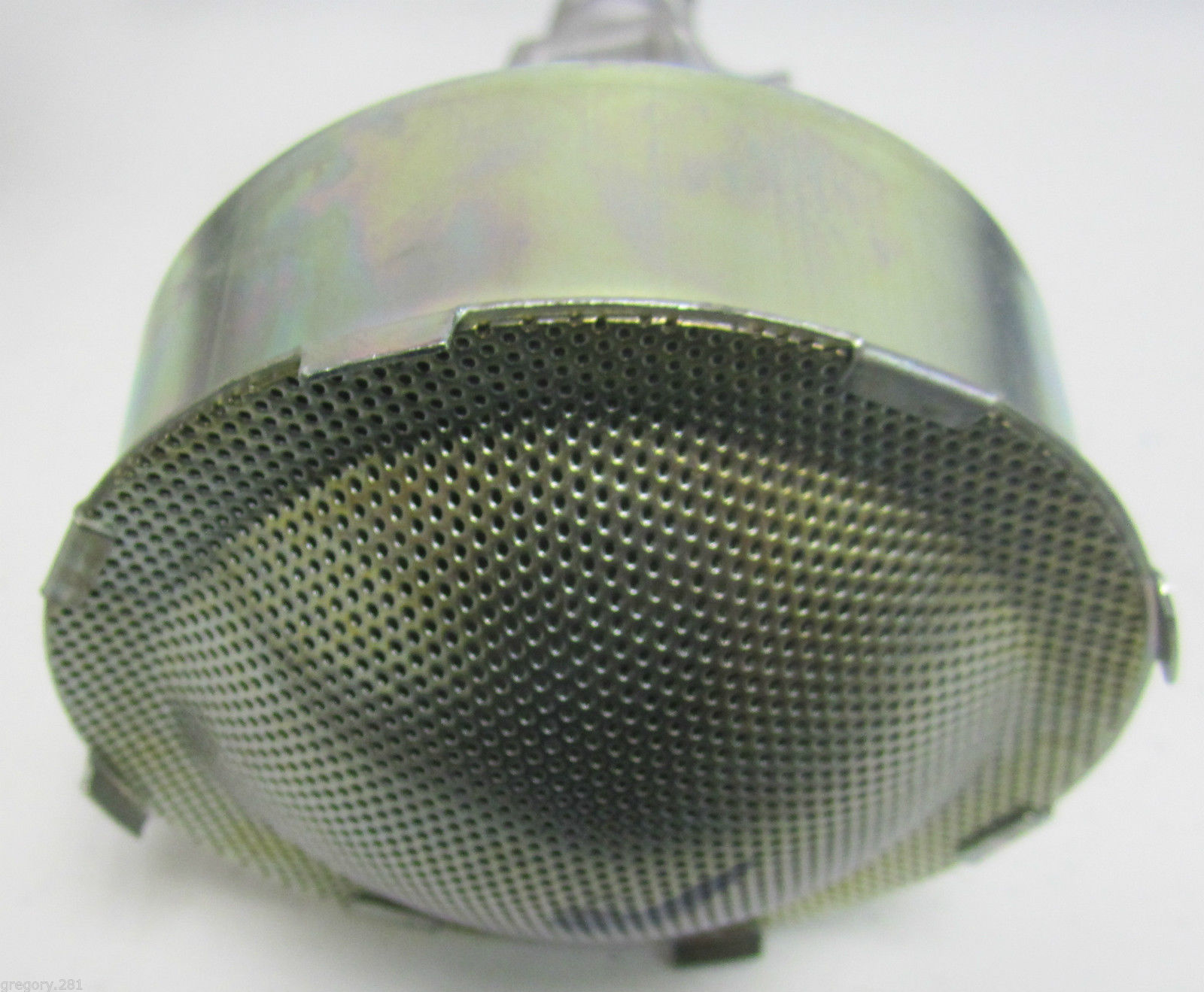

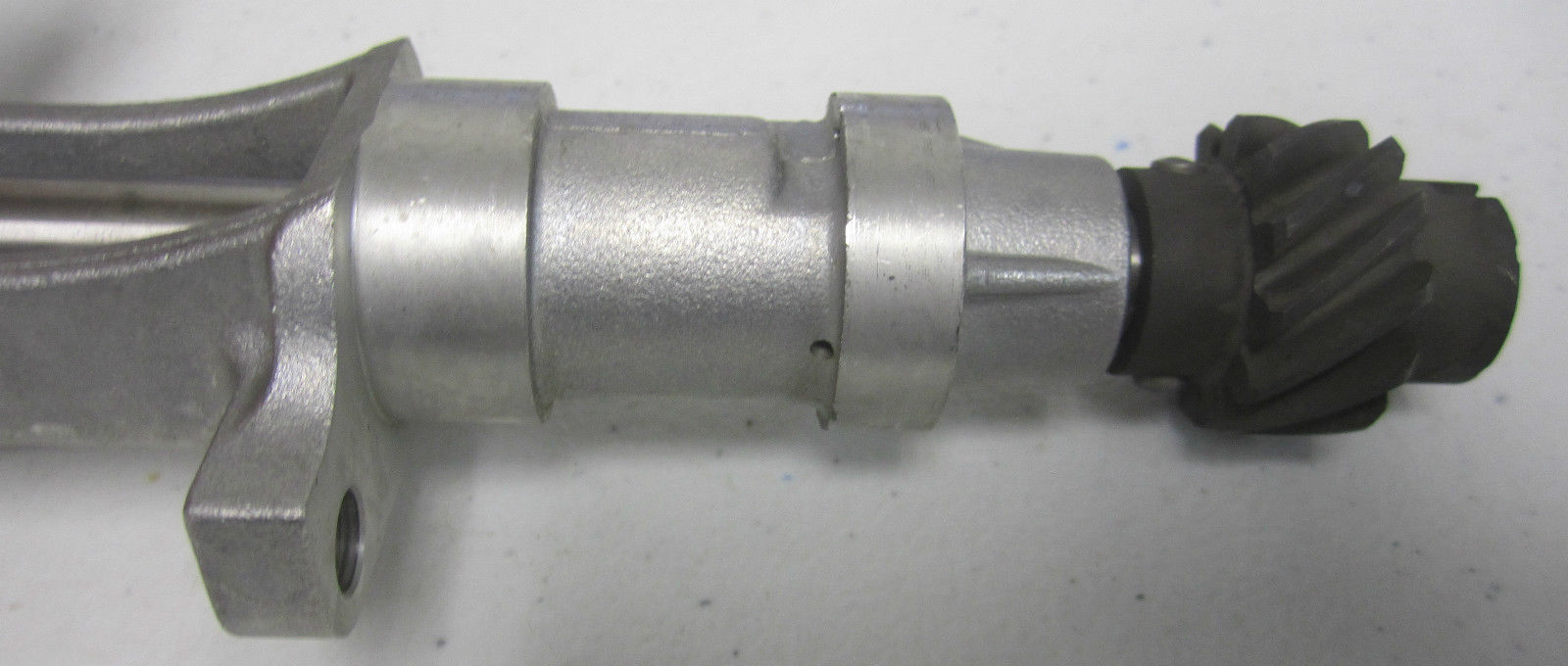

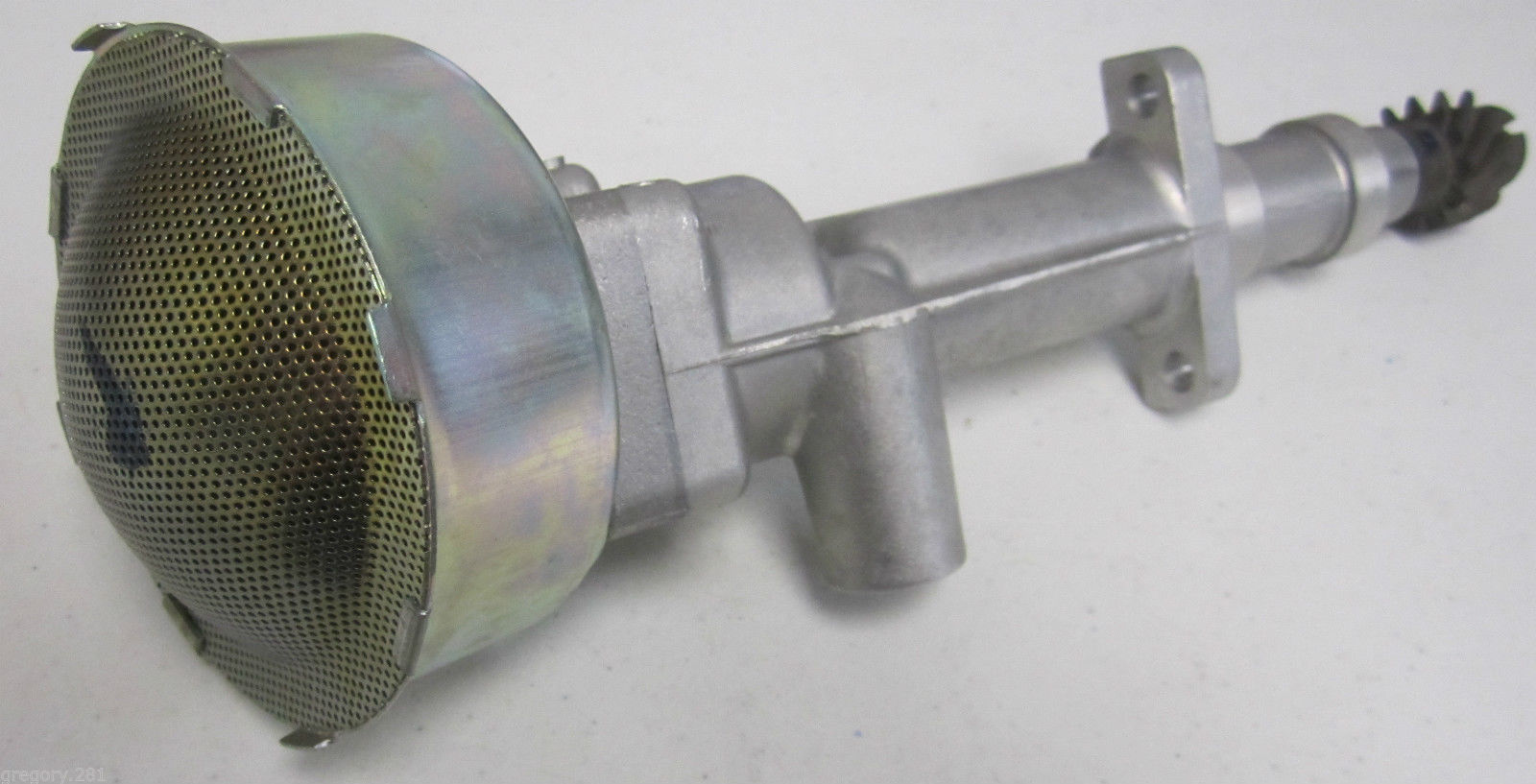

Here are the photos from the Ebay Advert:
Sun Nov 30, 2014 10:02 pm
eye wise they look identical ..hows the length ??? and how did you go with the other bellett in Darwin cheers davo

As Davo has indicated the length may be a governing factor. I know Isuzu when it went from the
G130 to the G150 the oil pump and oil galleries were changed internally. That G180 pump listed
is for a SOHC the same as Pom Bellett's and my GT convertible. Assuming that Isuzu used the
same for the G161SS and G180S.
Hoping that this info' is of assistance.
