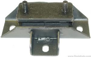

JT191
Joined: Wed Sep 24, 2008 10:05 am Posts: 543 Location: 12,450 miles away from the Big Warehouse in Melbourne
Chevy Luvs start with 1972, maybe later than the KB design.
This is only allowing one image attachment per post.
This is the Luv transmission mount.

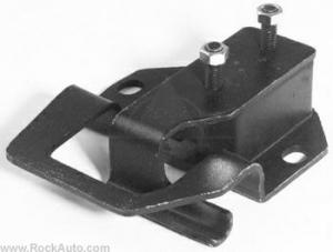

JT191
And the Luv motor mount.

1968GT
Joined: Tue Dec 23, 2008 2:32 am Posts: 1266 Location: MUDGEE. NSW
Brett, your idea I will try, I had not thought of the KB ute mounts. Surely the gear box mounts would be different due to the ute having a 5 speed box? If the engine mounts from the KB ute fitted your Wasp, they should surely fit the Bellett, or you would think so?
I don't remember seeing the gear box mount so JT191 I am not sure if that would fit or not, do have any idea there Brett? Dave M.

PR91
Joined: Tue Sep 16, 2008 11:54 am Posts: 2544
Those engine mounts posted by JT are the ones I used on the Wasp. Looking at them now, they are slightly different to a Bellett one, but nothing a small trim and a new mounting hole can't fix. In that pic, the "loop" of steel and the "tab" under it aren't on a Bellett mount, so they could be removed. Also, from memory, the holes in the Luv mount were too wide for a Bellett. The hole at the foreground of the pic will line up, but the other hole doesn't, requiring a new hole to be drilled and the extra steel on the plate to be removed as well.
The gearbox mount looks very, very Bellett. The only difference I can see is that a Bellett doesn't have the extra "tab" that is on that mount in the foreground of that pic. Again, a quick removal is in order.
Dave, as for the 5 speed question... They actually mount the same. My Wasp has a DOHC 5 speed and uses a Bellett box mount on the Wasp chassis, and my race sedan has a Gemini 5 speed and uses a Bellett mount as well. Mr Isuzu kindly made the later box's so that a Bellett mount would bolt straight to a DOHC/Gemini box, even though the DOHC/Gemini mount looks totally different to the Bellett one. Hope this helps mate! Also, while I'm working from memory here, please just check the mounts and dimensions if you're going to spend money on them, as I'd hate to think money has been wasted if they don't work out. Let me know how you get on. Cheers. Brett.

Heys Guys, Brett, Ross and JT191, I have seen the Luv mounts, Thank you Ross. Would you have to cut off those extra lugs? (I.E. do they get in the way) Do the bolt and bolt holes line up?
I am far from a mechanic and don't like having to "muckaround" a lot to fix thgis, they would be spares as I don't think I have a problem at the moment, however I want ot be prepared. Last year on my way back to Mudgee from Motofest, my light switch broke and I did not have a spare, result was driving the last 40 klms in Pitch black dark, NOT EVEN A MOON, using my blinkers to see where the road was, VERY INTERESTING!! DM.

PR91
gday dave. sorry mate, have only just seen your post.
at a guess, i'd say u wouldn't have to cut the loop and tab off, as there's a bit of room there in a Bellett engine bay, but personally, i would remove them. it'd only be a case of a quick hacksaw cut or 2 anyway. my GT is slightly modified here and there, so it wouldn't be a real "originality" concern for me, but on a GT as beautiful as yours, especially being restored as close to original as it is, i think they'd look far better being an "original" looking mount.
as for the holes....?? i honestly don't know, as when i had a look at my Wasp again, the mounts i have used are very similar to those, but not exact. the pic looks like they are very close to a Bellett one (if the loop and tab wasn't there), but having said that, the holes on a Wasp chassis are further apart than on a Bellett crossmember, and as they are listed for a Luv, they might need triming and a new hole drilled as well. the hole that's visible in the pic looks like it would line up, but the Luv mounts i used in my Wasp had one side that was wider than the other when measured from the rubber block, and the hole was out further as a result. of course, this is on the other side of the mount that's in the pic, and while it too is visible, the angle of the pic makes it hard to tell the distance between the rubber and the hole for sure......... again, sorry, without a look at one, it's just difficult to tell.

1968GT
Thank you Brett. they are not expensive, so maybe I purchase 1 and see if it all matches up, and yes you could take off those loops, however heat might be a problem if you use a angle grinder, so yes a hack saw would be the better option. I will let you know when I have time, how I go for everyones benefit. I have acquired however a coupls of old good condition engine mounts which will get me out of trouble if anything happens mean time. After Motofest, driving the GT back to Mudgee today, it is going really well. All the best Dave.
