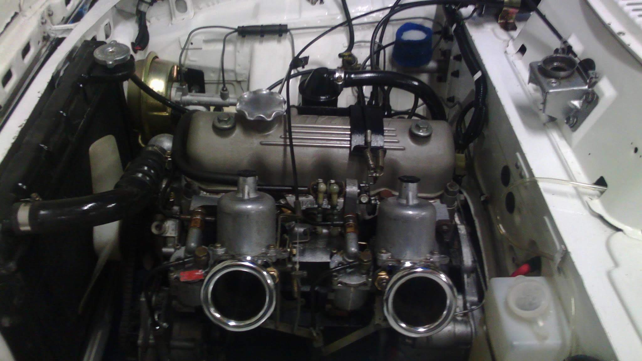

Author:  PR91 [ Wed Dec 14, 2016 12:55 am ]
Post subject:  Re: fan blades
11885767_10200979935658626_75357380696336867_o (1).jpg [ 251.94 KiB | Viewed 65275 times ]
Gemini fans.
Any rear wheel drive 1975 - 1984 TX - TG Gemini will have one. Front wheel drive RB Gemini is different.
Rodeo an Jackaroo is different again, but will just fit with some fiddling. Best off to use the more common Gemini one.
