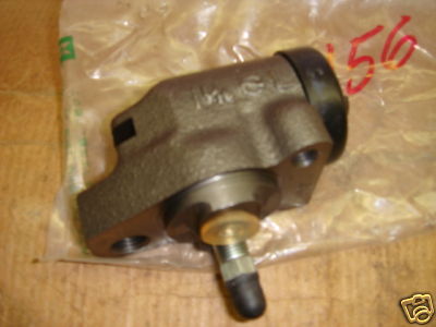

Check theese out on eBay they're used in 72-75 Chevy Luvs drum brake fronts.
http://cgi.ebay.com/ebaymotors/72-75-CH ... 3a1318Q7c3

I'm afraid the Luv brake are quite different - probably because of the difference in lugs etc?

I should have looked better, sorry! It's the same thing, the angle confused me... bought one, now all I have to do is wait for it to turn up. Thanks guys for the quick responses!

No no no, it's all wrong... comparing the pics I should have seen it. Has anyone got any ideas? I'll try to contact IZU069 again...

The big difference is the sort of trapezoidal piece that the originals have, the upper part on my pics. The others don't have that extra bit. I have now sourced a set of the right cylinders though!
