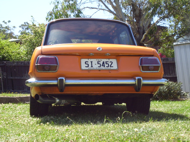

Here is a picture of the rear and how well Asroc's wheels fill the guards
For the record a mag wheel with with tyre on is usually 1 inch larger so 7" mags actualy equate to 8" with tyres so Asroc has 8" sqeezed under her guards
Sweeeeet
Sweeeeet

very Sweeet, love the car, love the look of those wheels, seem to suit it fine.
you just need a "Bellett" strip on boot lid now......

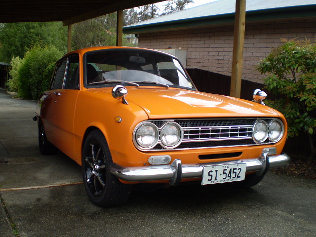

Thanks James. I would be interested in a picture of how the front sits in the guards ( front on ) as the +38 should narrow the track I would have thought. but I guess the extra width helps in this regard. As for the rear, by running a 5mm spacer ( which as you point out we can't do up here ), that would make it a +33 in effect. All of this is good news as it does make my search for wheels a little easier. Do you get any tyre rubbing on the rear at all ?

Your deductions are absolutely spot on
My front hubs have custom Volvo calipers and an effective machined spacing of approx 18mm out from standard so this would equate to approx offset of 20mm.
This is in keeping with Performance Supalites which are popular mags and run an offset of 18-24mm I think
Rear on Asroc 38-5mm=33mm but 15 inch is quite different to 14 inch mags in relation to clearance in rear guard
I am running 14 x 6.5 mags on rear of Bella with offset 18mm I think
So all said and done looks like 18-20mm +ve offset may be the magic figure for mags?

Here is the photo you requested from front
J
