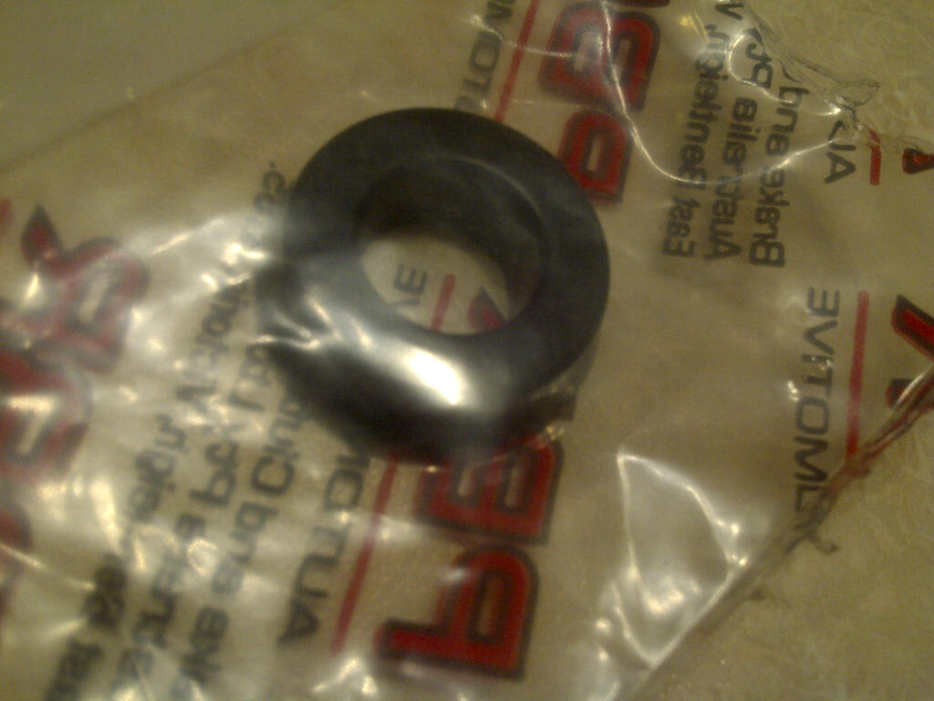

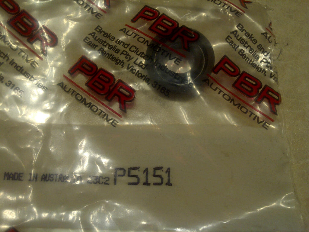

Front seal P6121
Rear seal P5151
Cyclinder Kit Master K7308X
below is pic of rear seal

Have tried to use MG magnette rear wheel cylinders which look pretty much identical to the morris 1000 ones as recommended by dick in Holland. Could not get rid of the air from the system as these cylinders don't have any bleed nipples. Be interested to hear how craig overcame this.
Also googled pbr trying to find part number p5151 but nothing seems to come up - dont understand why as i can see p5151 printed on the packet of the photo that oz toffa posted.
