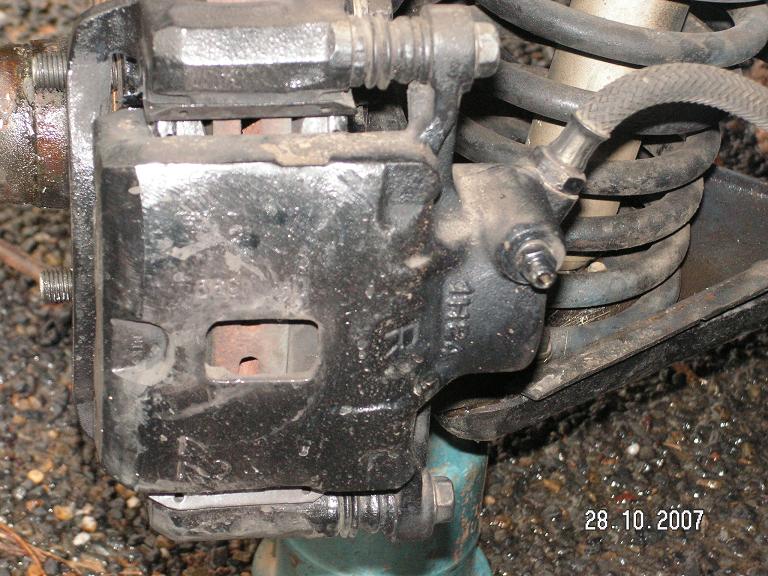

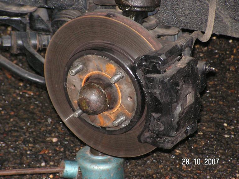

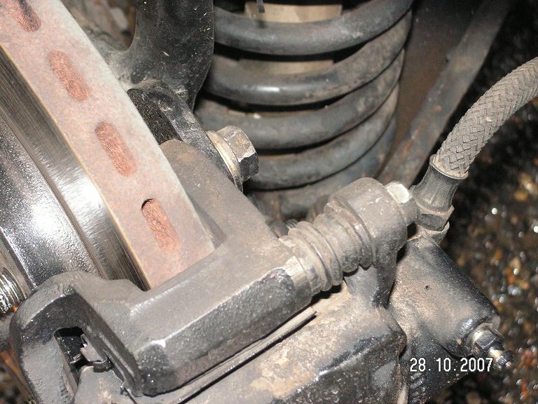

I can relate to the stub machining. I had my 1970 car turn turtle on me at Philip Island just as I was changing form second to third at 80 mph. It was a bit embarasing as I had an instructor in the passengers seat. Lucky it did not happe on the main straight as we were hitting well over 100 mph. I have GT disca on my sedan and will be going the Dubbo Way and using TP Magna. They use the standard Bellett drum hub. Just a bracket to make up for the caliper.

Just get a Magna 85-92 4-stud disc and its caliper. (Models like TP?)
Remove the 2 Magna caliper bolts and the disc just pulls off.
It will fit on the Bellett drum-brake hub (remove the drum and brakes!).
You'll need to manufacture a caliper mounting bracket.
I'm unsure about suitable backing plate/s, hose threads, and if 13" rims fit. (I may be able to find out...)
FYI - New Magna discs are 24mm with a wear limit of 22mm. (To think the GT Belletts were 10mm with a 7mm limit!)

A template for the TP conversion is around. I do have one but I am loath to pass it on at present. I am doing this conversion on my Bellett but have a new template that requires a laser cut to get it done. It utilises "ALL" 4 mounting bolts on the stub. I am not really happy with the original with only using 2 bolts. It is better to spread the load across the whole mounting area rather than 1/2 of it.
From the wreckers you will need
TP discs (new is better)
2 Calipers L & R
Both brake hoses and the nut that is on the steel pipe.
Recover "ALL" mounting bolts
Both backing plates (they may need a mod to fit)
I am about 4 weeks away from getting it set up so I will keep informed.
