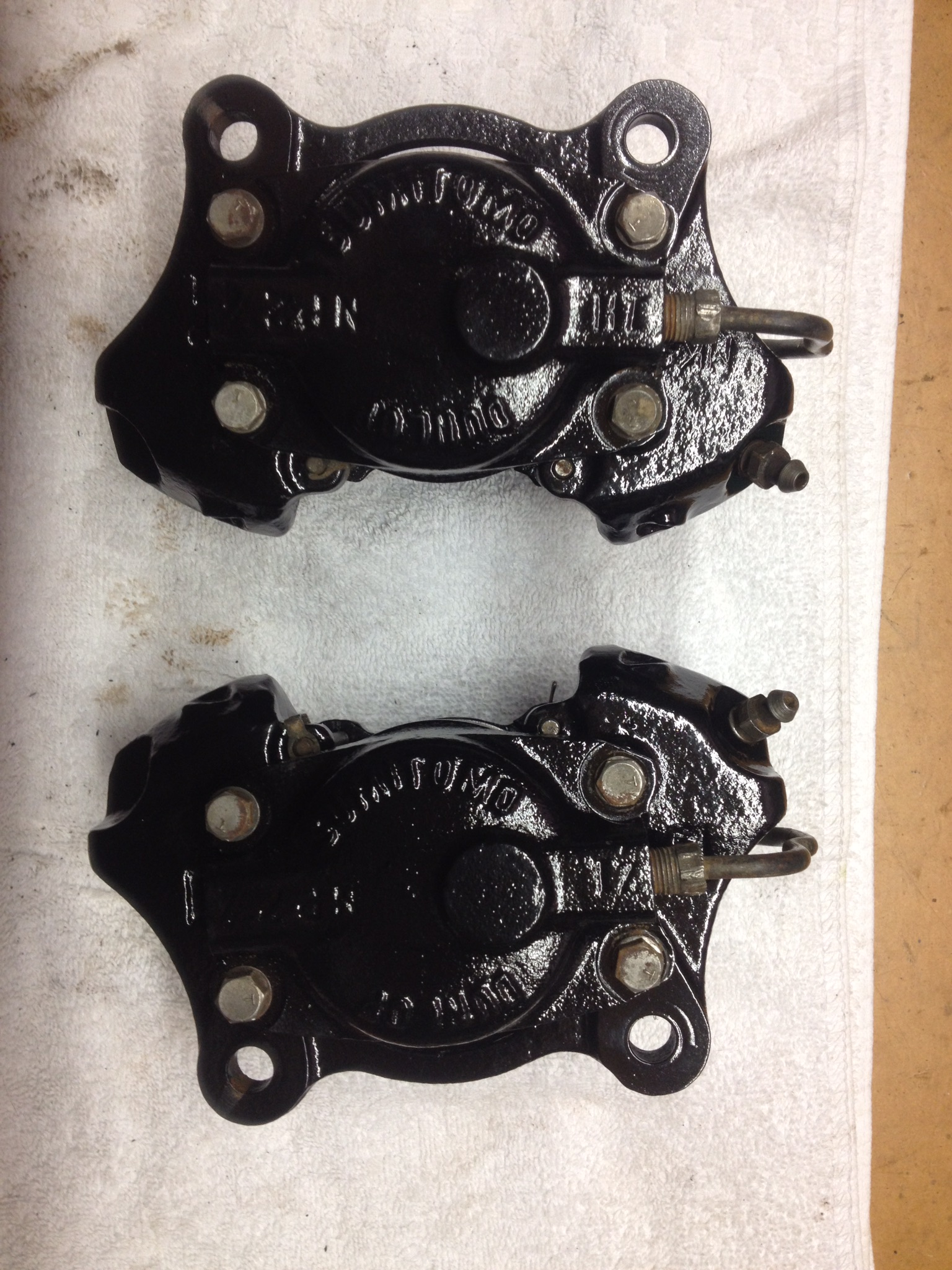

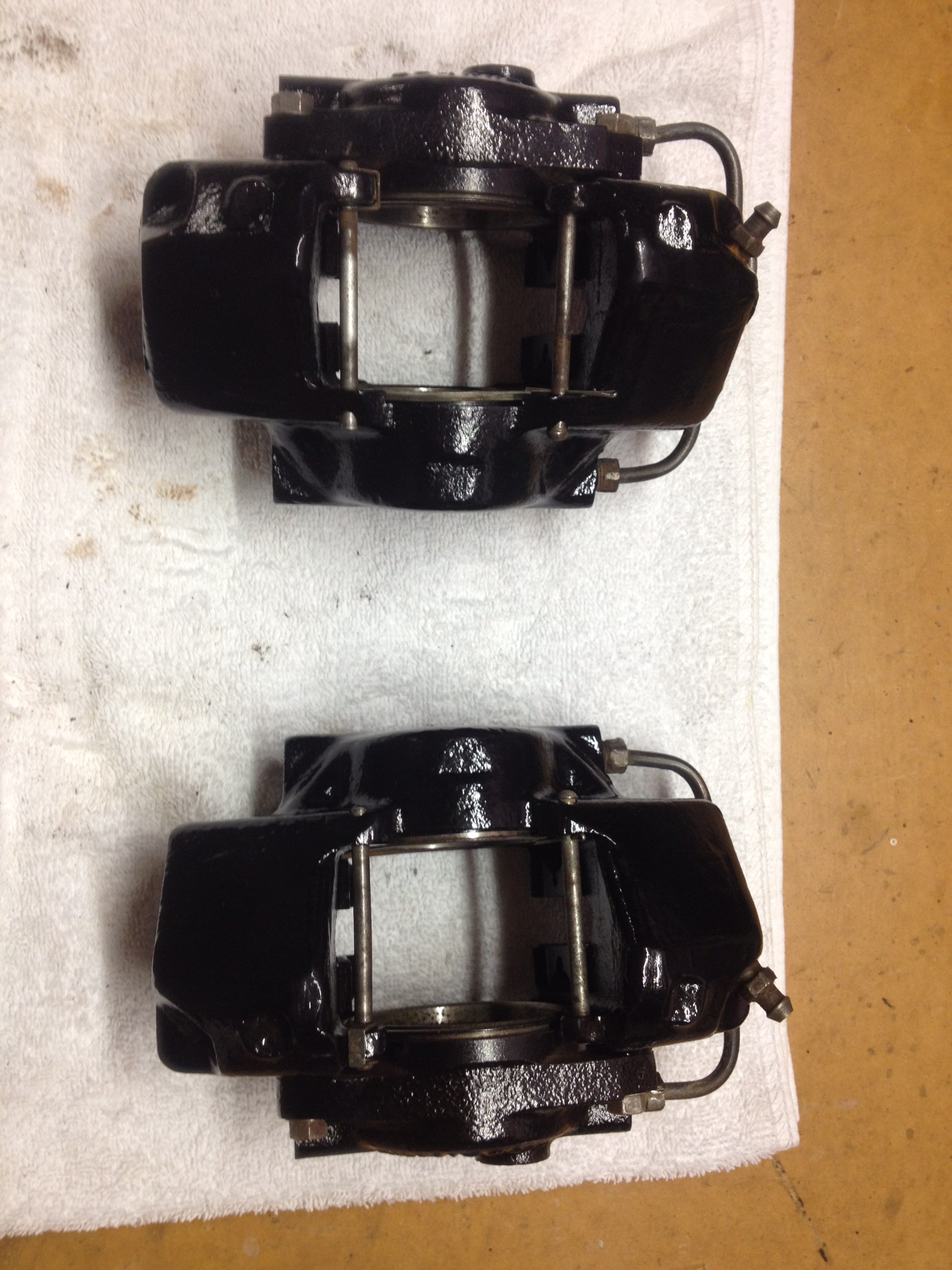

I am trying to find out what calipers are on my GT. I saw where Davo mentioned that he had fitted a front brake conversion to his GT but I am not sure if these are the conversion ones or genuine GT. The ones that I have do not have any pads and my parts book does not show pictures of Disk brakes. The car came with a photo album that shows these calipers were rebuilt but I will get them checked out as they may have rusted up since the rebuild. I think I may have found some NOS pads for a GT but I have no idea what they look like or dimensions. I would appreciate it if somebody could identify these calipers from the pictures provided and also send me a picture of some front pads. Hopefully they are GT and the pads I have found will fit. Many thanks

Are the calipers that I posted pictures of from a GT? as they came with the car when I bought it

Yes they are GT calipers

I've used Wayne at Better Brakes Southport for same calipers on the Tassie Devil, good job,knows his stuff,the pads are small square from memory 47115-301 isuzu number out of Gt parts book ,good luck Gerry
