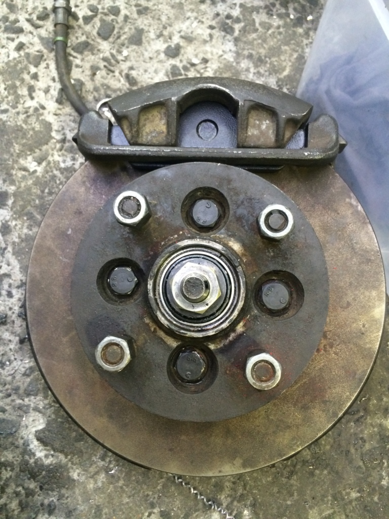

Hi all
a few photos for you. Bellett GT hubs, GE Sigma discs (13mm solid) early GE Sigma calipers (Girlock not PBR).
YP

any more details ? any machining for example? It looks like a lot of meat has been taken from the caliper?
It appears that rotor bolts direct to the hub ?

You're getting very close Glenn,
No machining of caliper but the large "spacer" in the bellett hub has had about 4-5mm machined off it so that the rotor runs in the centre of the calipers. The original caliper mount has to be re-tapped to take the Sigma caliper bolts which are just a few thou larger.
I took all the bits to a local auto engineering shop. He did it for mates rates including pads...but I know him fairly well.
His only lament was that I we couldn't fit ventilated rotors!!!

Hi YP.
When you bolted the disc to the hub. Did you use a bolt and nut or did you tap a thread into the disc. :?:
Most of the discs that I was able to get and try were not threaded and there wasn't much room behind to
clear the the head of the bolts on the stearing arm. My concern is that the nut,if it worked loose, would foul
those bolts.

Hi Dave
Good to hear from you. Hope you're well.
It was a bolt and nut to fix the rotor as used in the original Gt set up.
YP
