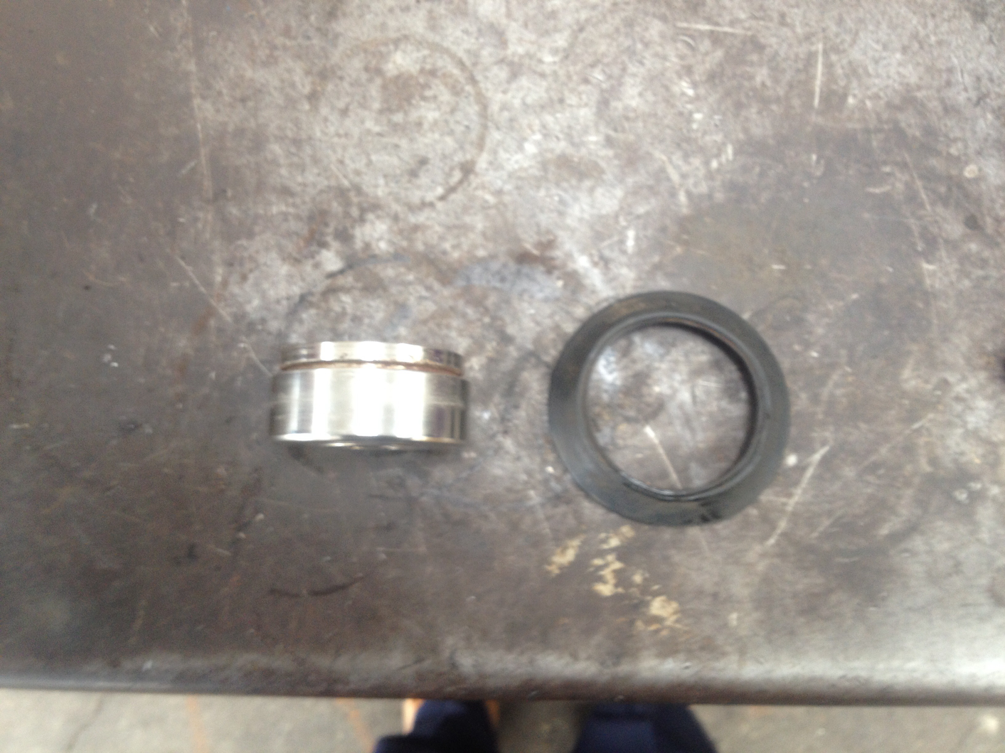

Ok Guys
Now please refrain from laughing but.....
Has anyone got serviceable GT brake Pistons that they are willing to part with
Out of 9 I scrummaged so far only 1 is useable
So I need 3...
Also need a set of dust boots as per photo
Can anyone help
Thanks
J

Spent the morning on the phone and ended up visiting local brake, clutch, machine / fabrication shop
Left them a sacrificial piston to de-construct and estimate cost of fabricating with central shaft in stainless
Will let you know if doesn't cost one's 1st born
J

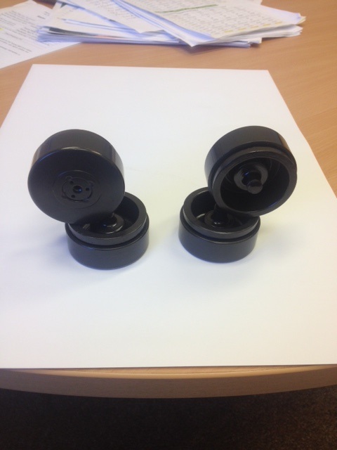

Tue Sep 29, 2015 10:10 pm
Posts: 428
Location: Sydney NSW

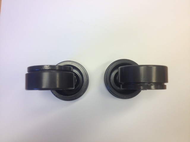

Just picked up the pistons from the Ceramic Coaters
3 are definitely useable, 4th touch and go as likely to 'seep' which may be OK on weekend driver but not daily driver so I will give it a go.......
Interim step to Sleeving if pitting minimal at about 1/3 cost........
J
