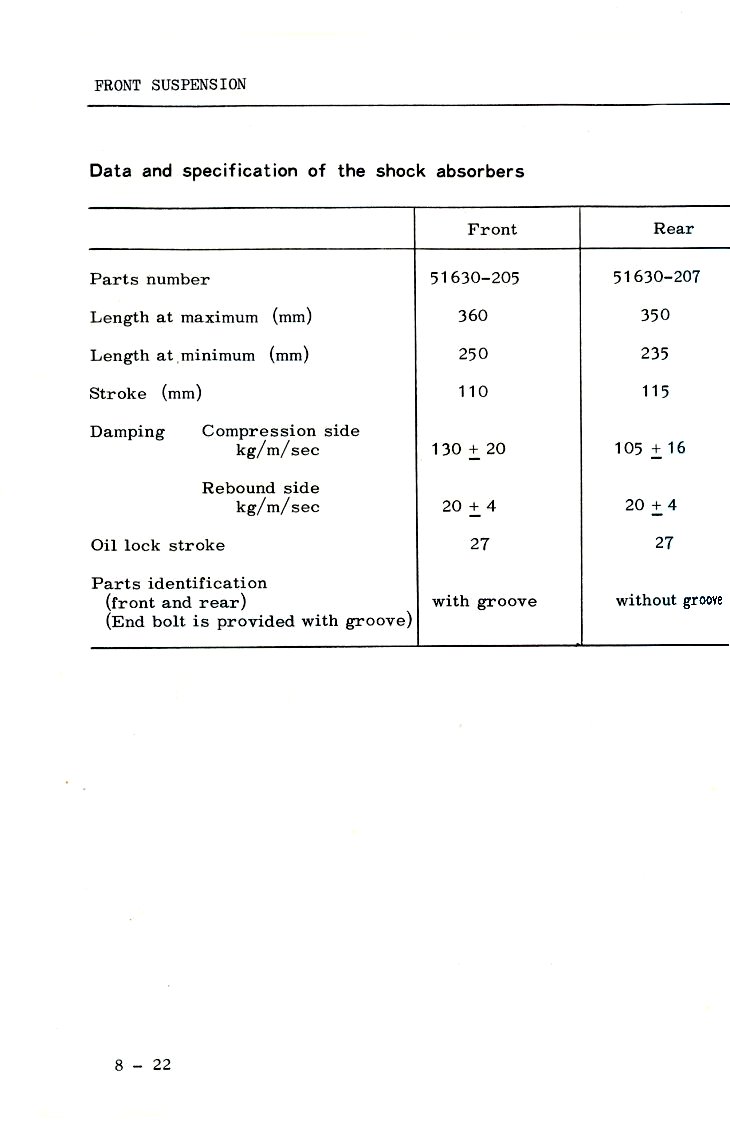

Anyway, I scanned in the shock absorber chart. Front max length of about 14.17 inches, min length of about 9.84 inches, mid point for at rest position under load would be 12 inches. Rear max length 13.78 inches, min length 9.25 inches, mid point for rest position under load would be 11.52 inches.
The bad news is that the shortest coilover we deal with is 15.68 inches at rest length, so it is too long for a Bellett. Looking at the Hakosukas, they have strut suspension with high mounted camber plates, so they look like coilovers are easy on those. The Bellett upper shock mounting point is a stud. And it looks like camber is adjusted via a shim between the upper trailing arm bracket and the body of the car. At some point, in 1964 or 1965, somebody in Japan made a decision to really mess up my plans and any chance of a Saturday afternoon alignment change from street settings to track settings for Sunday morning racing.
Worse news is that I am not seeing much in double adjustable shocks with a 14 inch max length and 9 inch min length. The muscle car stuff is too long and the formula car stuff does not have enough stroke.
File comment: Shock Data
