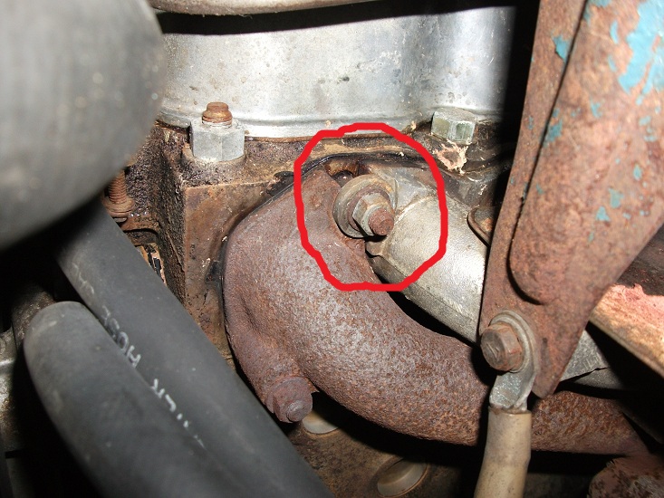

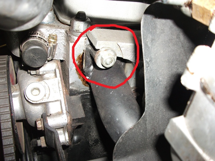

so we all know what were on about, there were actually 3 different Bellett's heads produced.
the earlier cast iron, round port 1500 sedan head.
the later alloy 1500, square port 1500 sedan & 1600 florian head.
and the alloy 1600, square port GT head.
the 2 alloy heads are different in the bolt pattern where the manifold/s bolt on, as the sedan/flo had was a different layout to the GT.
hence, there are 3 different manifold configurations for a Bellett.
the cast iron and alloy sedan heads use the same bolt pattern, even tho the port shape is different.
i know this as i was given use of an alloy sedan head twin weber manifold to use on my GT when i resto'd it (i was going to use webers on it....), but then found out pretty quickly that it didn't match the bolt pattern....
i'll be in my factory today, and i have cars with both of these alloy heads, so i'll get a couple of pics and post them.
cheers.
Fri Nov 12, 2010 10:06 pm
Posts: 199
Thanks PR91, thought there were differences but was not sure. That is the good thing of this forum, many people have been around Belletts and know the slight variations. This in the end saves time and money for others building their cars. Thanks for sharing.
Sat Nov 13, 2010 12:29 am
ok, here's the differnece in GT to sedan manifold mountings:
*the different mountings are across the entire manifold face, not just at cylinder number 1. i have only shown number 1 as it's the easiest to photograph and see easily for reference*
sedan: note location of top bolt/stud on number 1 cylinder, circled in red.
is at "1 o'clock".
GT: note location of top bolt/stud on number 1 cylinder again, circled in red.
is at "11 o'clock".
very basically, the sedan heads have the 'close spaced' bolts/studs along the top row and the 'wide spaced' ones along the bottom, while the GT is exactly the opposite.
and yes, that makes the sedan and GT manifold gaskets different to each other too, just to make things a bit harder for us all....
