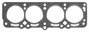

doesn't that out of round cause problems though on DOHC ?
This should be the SOHC gasket:- (need to verify)
A G200W set is on ebay (Oz) Item number: 261018545307
