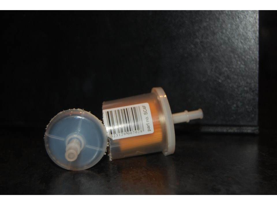

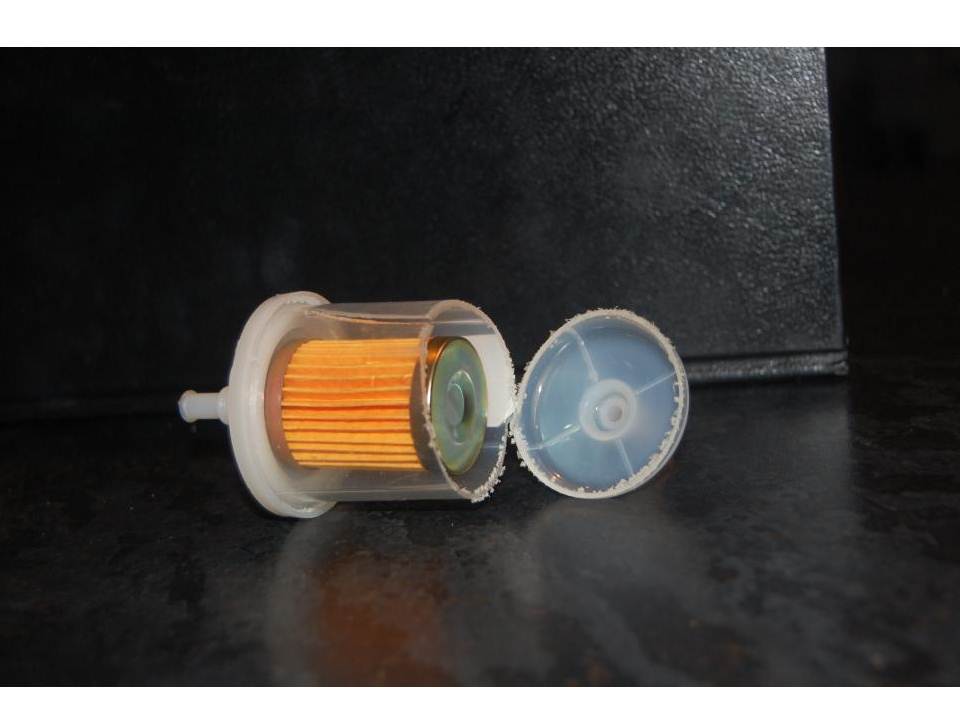

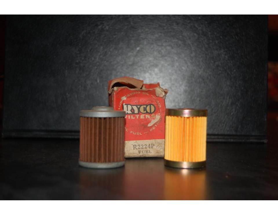

RANG RYCO TODAY NO LUCK ON ANY GENUINE R2224P ORIGINAL FUEL FILTER WENT TO SUPER CHEAP BOUGHT THE PLASTIC FUEL FILTER $2.99 HAD A LOOK AND THOUGHT GEEZ THATS CLOSE SO TOOK IT HOME CUT THE LID OF AND ITS VIRTUALLY A PERFECT MATCH UNSCREWED THE FILTER PUSHED IN THE NEW YOU BEAUT FROM SUPER CHEAP ...AND AWAY WE GO ....SO WENT BACK AND BOUGHT A SPARE ...HANG THE EXPENSE ....CHEERS DAVO

hi brett part no. SC4F BARCODE 9323129007028 CHEERS DAVO

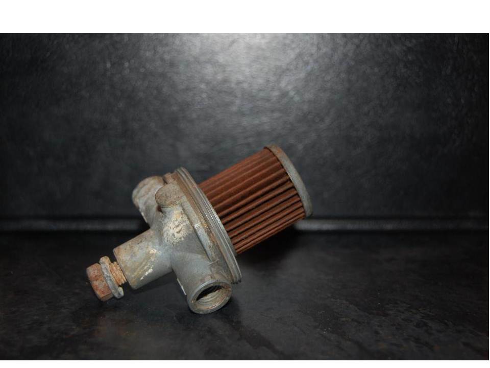

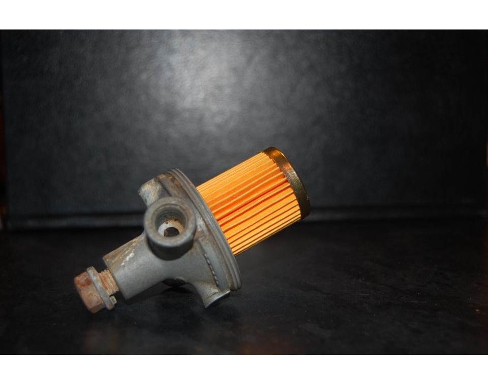

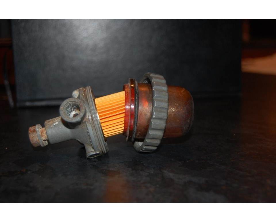

hi guys at last i got the car running and especially to check if the filter worked ..leaked etc .....took out the old one (tin) and pushed in the new plastic filter firmly put on the rubber seal tightened it all up started the car and watched ..ran the car ...no problems they work they are easy to get and easy to fit ...just cut the top of the new plastic filter and pull out the identical looking filter great stuff cheers davo supercheap autos .....if you cant get em let me know i will get some here

I went and bought a filter on Saturday arvo. Sliced it open that night and removed element. It's uncanny how that filter is nearly the same as the original. Only difference that I found was the hole diameter. Put an extra 'o' ring to seal it off.

here goes it works for me no leaks car ran for 10 mins cheers davo if you cant work it out email me

Looks spot-on Davo, great work!
A cheap solution to the disappearing parts problem.
