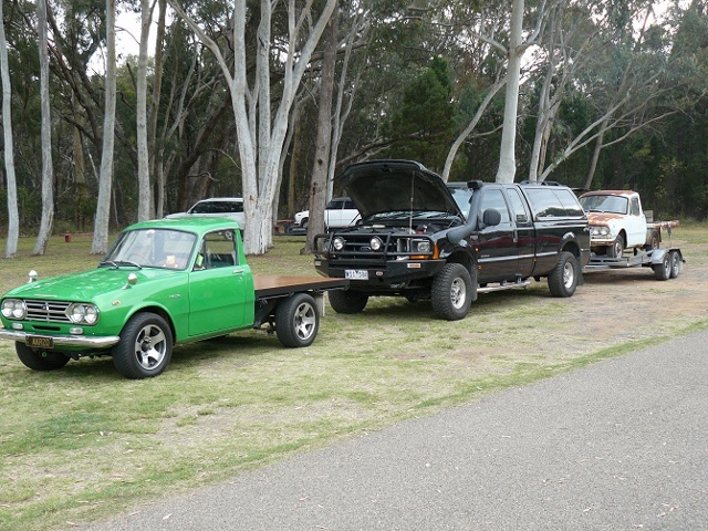

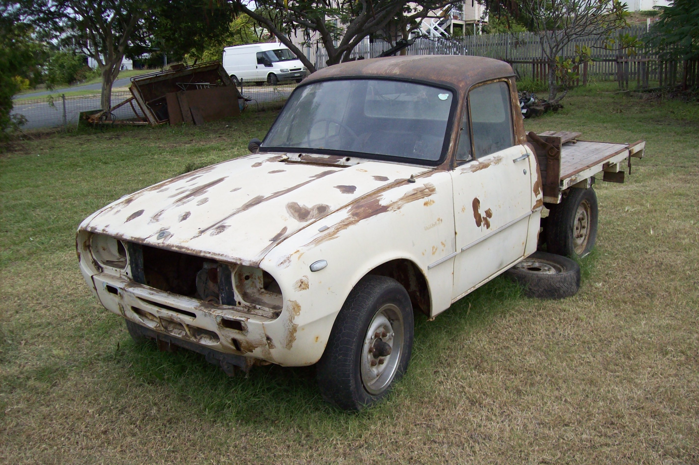

Not sure if this will work. First try.
If it does work. I might put in a thread on all my cars and utes.
File comment: 'Neville'. Good for spares only.
File comment: This is 'Harry'.
Wed Jun 13, 2012 12:46 pm
Thanks for the Wasp pics. You must be the Dave with the 2 Wasps.......
Thu Jun 14, 2012 12:15 am
bloody strong cars those wasps towing that landrover unbeleivable ...mate looks like they are all there . painted and off to merrimbula better hurry mate times running out cheers davo and thanks for the photos

Thu Jun 14, 2012 8:59 am
KB,
I am the Dave with 2 Wasps, 2 Sedans & 1 Gt.
The sedan on the trailer behind Gricey's 250 in gt Orph's picture above is 1 of them.
You gave me the door check for it.
Obviously the pics worked. Going to do some research in all my photos so as I can do an introduction
of myself.
