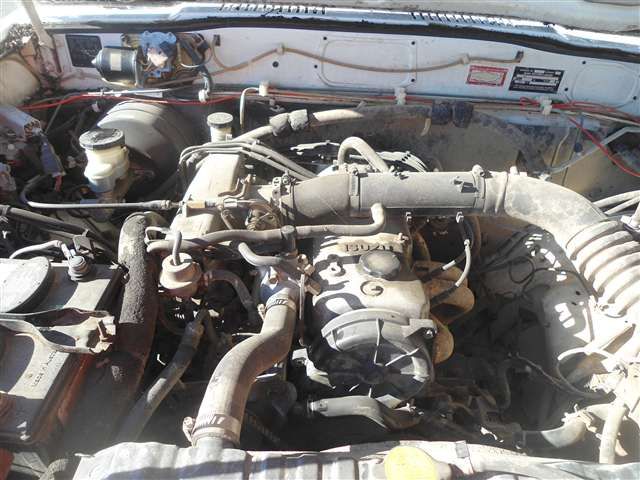

Anybody know if the inlet manifold from a Jackaroo will fit on a G200 DOHC engine ??
they look similar but I am not sure if the engine side will be the same? (probably not !)
If I can get the 117 engine it has the manifold that won't fit a bellett. Need to change to the ECGI type.

Sat Aug 04, 2012 6:56 am
answer is NO fit
Sat Aug 04, 2012 7:41 am
Bugger.....
not even close ?
adapter maybe? cut and shut ?
thanks Greg

I'm looking way in the future here at moment. Prime reason to get the 117 engine is the gearbox with idea maybe one day to fit the DOHC to 2nd car if it proves to be worth re-building.
Was planning to go the Astra/Camira Delco computer conversion route for the efi. For that i need the ECGI type manifold or 2nd choice, make my own but that won't look 'factory'.
Or if can find some GT type carbies, just fit them !

I have a mould to make weber manifolds for them. If you need a set made :?:
Sat Aug 04, 2012 9:18 am
Sounds good. Like to do the EFI but carbs probably simpler to do

delco efi is not that hard :?: i did a write up here i think its under 1 of flyings threads :?: theres that memory bank thing again :lol:

Ah, the dreaded tinworm in the towers. Something that seems to take quite a long time to show itself. And repair.
SU's are ok though. Webers nice but i think a bit pricey to buy and setup.
I just copied Gregs info on the EFI conversion. Lot's of questions really left on that one but no hurry for me. Still waiting for the car. I had a look at the Delcohacking.net pages. There's a lot of info there on fitting a PUlsar/Astra/Nissan efi system to various engines. Last weekend i actually went to the wreckers to sus out the cars and actually bought an ECU too. ($41) No time to lift all the other bits needed and a lot to learn too.. Anyway, carbs are fine for now.
Wed Aug 08, 2012 4:07 am
as greg said....
nope. manifold isn't even close.
those 4z series manifolds are interchangable with G-z gemini series engines tho, and we all know they won't fit a G-w.
Glenn.... how bout Weber manifolds with 4 throttle bodies? gives a carb look and sound, but advantages of EFI.
talk to Gavin and Ross about Delco too. Ross has done a few and swears by it, and your old white GT that Gav has is Delco'd now.
Fri Aug 10, 2012 7:56 am
Yes I have seen what Gavin has done on delco hackers .net. I prefer to have a factory look if possible. Not after the last word in performance. Just s cruiser really. Carbs though are simpler for a car used only occasionaly. Depends what I decide to do with the 117. Dohc engine really and how well the the sohc runs too.
