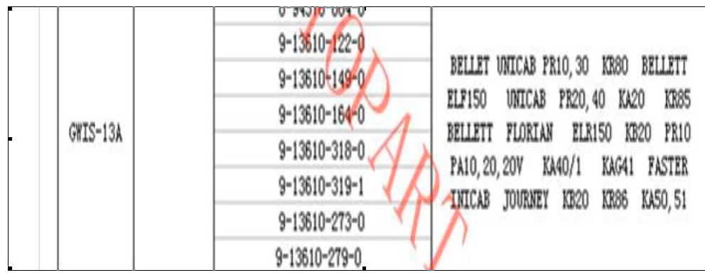

so ..I am a bit thick so the 1500 and the 1600 motor use the same water pump ??
the water pumps gmb ..part gwis-13a (stamped number 7yo5 on the pump)
is the one which we are chasing ?? is this correct ?? just I am trawling today ...who knows obviously these are a problem ...for our cars ..I was lucky and got one a couple of tears ago for my (since sold) teardrop from nz (now all gone) I thinl landed it was $80 mmmmmmm im on to it cheers davo

hi glenn or any any fellow bellettian I have been trawling the net came across a supposed supplier of water pumps said they have stock or did I want kits ?? now my question is they supposedly have gwis-13a in stock is this the same as the gmb -140-1130 pumps x new Zealand will they fit only a 1600 gt or do they fit the 1500 motor as well I realize some turn up here and woudnt even fit a skoda ..(an old one ) but I guess if I send pics and dimensions and say get one its worth a shot since this appears to be a lot of guys concerns ....have you got or anyone got some good pics to email to them they asked how many id want so apparently they have a stock we shall see cheers davo
Sat Apr 11, 2015 11:53 pm
I don't know, Dave
this is all i can glean from web:
