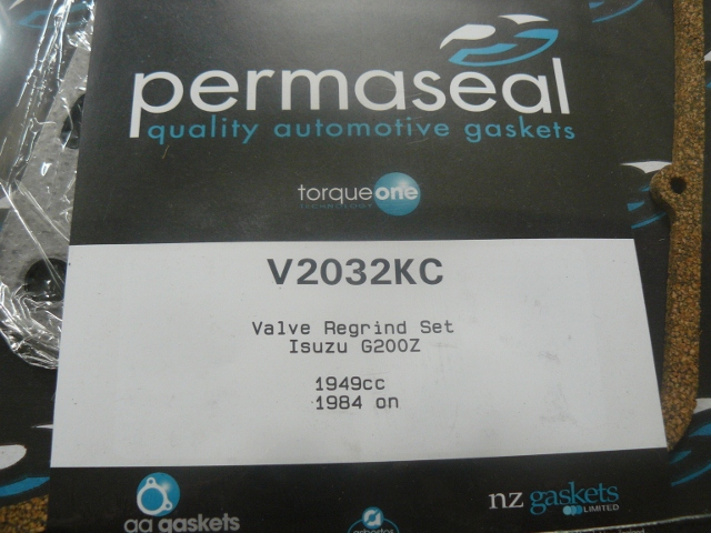

just in case you think i am F.O.S.
I spoke to Adam at morayfield store and he said they are still available if you have drama's he is expecting your call 07 54993533 he said they get them out of vic [that big victorian wharehouse]. :lol:

and there's more, quick phn call here to local Bursons.
V2032KC VRS set for G200Z as above.
They are available at Cost of $204.25 + $12 freight charge.
Wed Jun 27, 2012 6:19 am

Call to local burons again, gave them the part number - what engine is it for? Errr i dont know. :roll: Just got off the phone to AAA Gaskets and your right it does exist sooooo going to order one now.
Wed Jun 27, 2012 6:22 am
told ya i was not F.O.S This time anyway.
BTW i have been paying $135.99 plus gst ;) trade there is room to move :?: ;) ;) ;)

Wed Jun 27, 2012 9:00 pm
trust me....
that bursons kit is for a W series DOHC, not a Z series SOHC.
the listing on their system is wrong, and that's why when u go in and ask for an "Isuzu G200W DOHC" anything, it doesn't show up....
