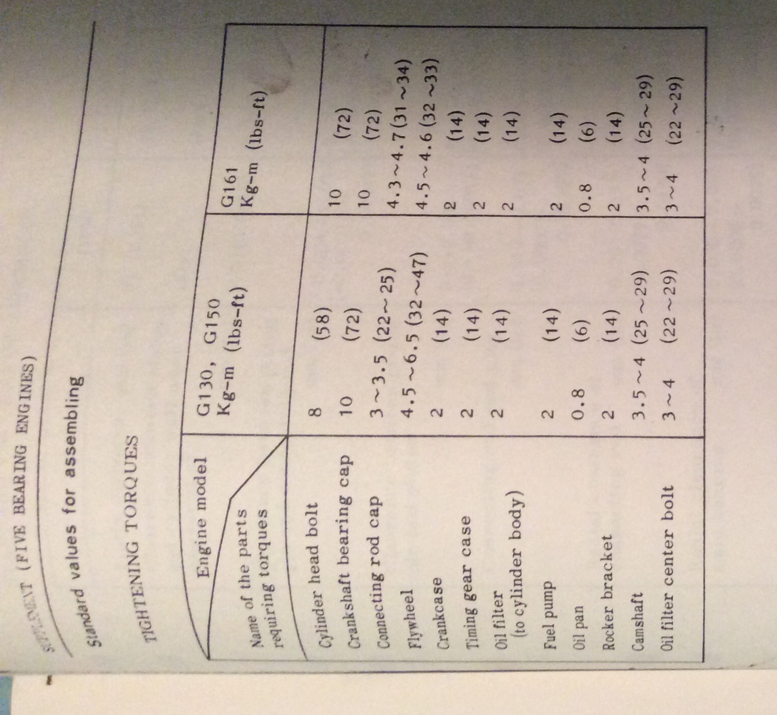

So does anyone have the correct tension for the rocker stand bolts ?

Sun Jan 08, 2017 7:33 pm
Here is the table of tightening torques for 5 bearing engines,
Lewis.
Sun Jan 08, 2017 7:56 pm
Yippee.
Thank you so much
:D
Sun Jan 08, 2017 8:53 pm
Lewis beet me to it.
That is the same book I have.
