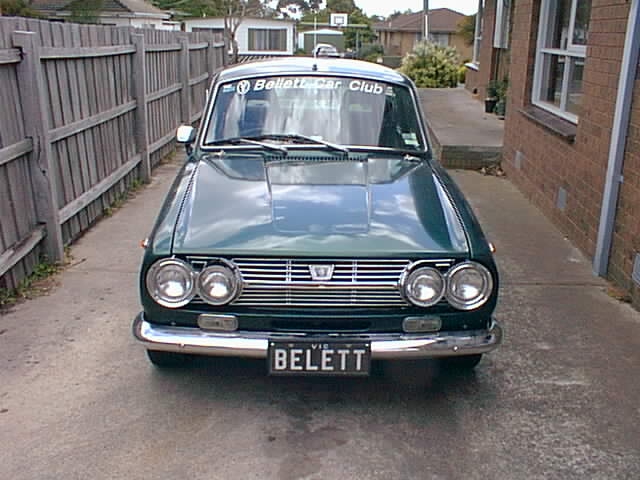

Your right on nearly all the counts. Stainless grille I wish. Maybe on PR90 but PR20 had a dreadfully thin chrome one. Maybe that is why I am putting a late alloy and mesh one back in.
