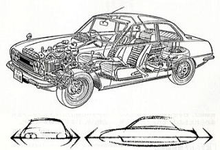

File comment: Picture from the page :

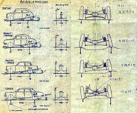

When did you start in earnest the development of Vered in May 1960, I was appointed to the chief clerk under Mr. Mizusawa passenger car design department. Before that. Under the chief Hotta stone registration, had been working on the design of the suspension finished the design of the transmission of Vered and chassis design other Resona. Have mastered the design technology of independent suspension front wheel of Bereru Division mechanism design
the suspension of the author encounter with the design, the committee of the authors Mr. Okubo at the time that has absorbed the knowledge from the outside. This is also a lot is that it has joined as a member to the Technical Committee the spring of the Society of Automotive Engineers and the length of the professor, passage of the University of Tokyo after joining Technical Committee spring. I think is from was decided to attend the meeting, if there is no such opportunities, and was not able to participate in the design of Vered the author does not stop research just, Professor Watari is automobile companies participating The prototype of the spring piece for large buses with no cases in the world aimed at improving ride quality proposed by, went to test ride. Isuzu bus Isuzu in bad road, such as route Kusatsu at that time in collaboration with the Railways during this of all leaf spring suspension system of heavy-duty truck was blessed with many opportunities to receive technical guidance for structural strength and vibration engineering Railway Technical Research Institute Mr. Matsudaira length, from Mr. Kunieda measures involved in the project broken leaf spring. by this experience was supposed to be in charge of the design of one hand.
Ito, Director of Research at the time, understanding will also Mr. Okubo此design. was able to engage in research on semi-active suspension in the United States MIT was a further six months of 1955 the heavy responsibility that the vehicle responsible for the development of the finishing period between the release from the trial after returning home. that could not be realized unless I get admitted to leave the workplace by half a year, he joined the design group of the newly developed eight-ton truck TD given. That was fortunate enough to be left after the chief Shigeru Inoue was also boss is此.
there was this thing is immeasurable effectiveness there is a preparatory stage prior to the development of two important Vered now.
One is a suspension Seminar meeting. Over 30 of the development department, including those directly related to non-30, leading to new employees from deputy director took part in was a half year period. The meeting was held on overtime hours. Research at the time of the suspension was the hottest theme of engineers in the automotive industry. Was able to understand the concept sharing center say roll, axle steer, reverse steer, and move, such as for example an in-weighted techniques such as non-experimental research design for this result.
Although the following was most used car was purchased by the bold decision of the vehicle reference Vered, director of research development of Ito. From the circumstances of the time, VW Beetle, Renault Dauphin, Morris 1100, Morris Minor, DKW, Triumph, other domestic front-wheel drive such as car, rear-wheel drive, had been covering the method suspension various FF, FR, RR, coil, leaf spring and torsion bar. These are not only been subjected to the test simply, design, research . over chief clerk is allowed to use to commute to work in shifts, was driven with the feel of driving
