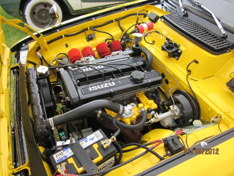

You can also fabricate a manifold for them to run webers. One example was at the nats also of this. The yellow car i think. If you know a aluminium welder mate, then it would not be that hard to do.
Thu Oct 25, 2012 1:50 am
Gav described his ex-Glenn Percy/ex-Gunna (Dean)/ex-Dave G200 Bellett GT as a "torque monster" now that it's running a GM Delco system.

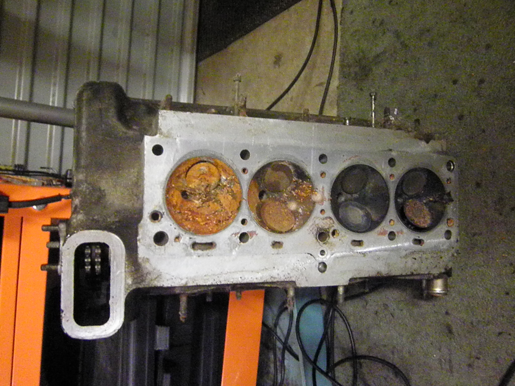

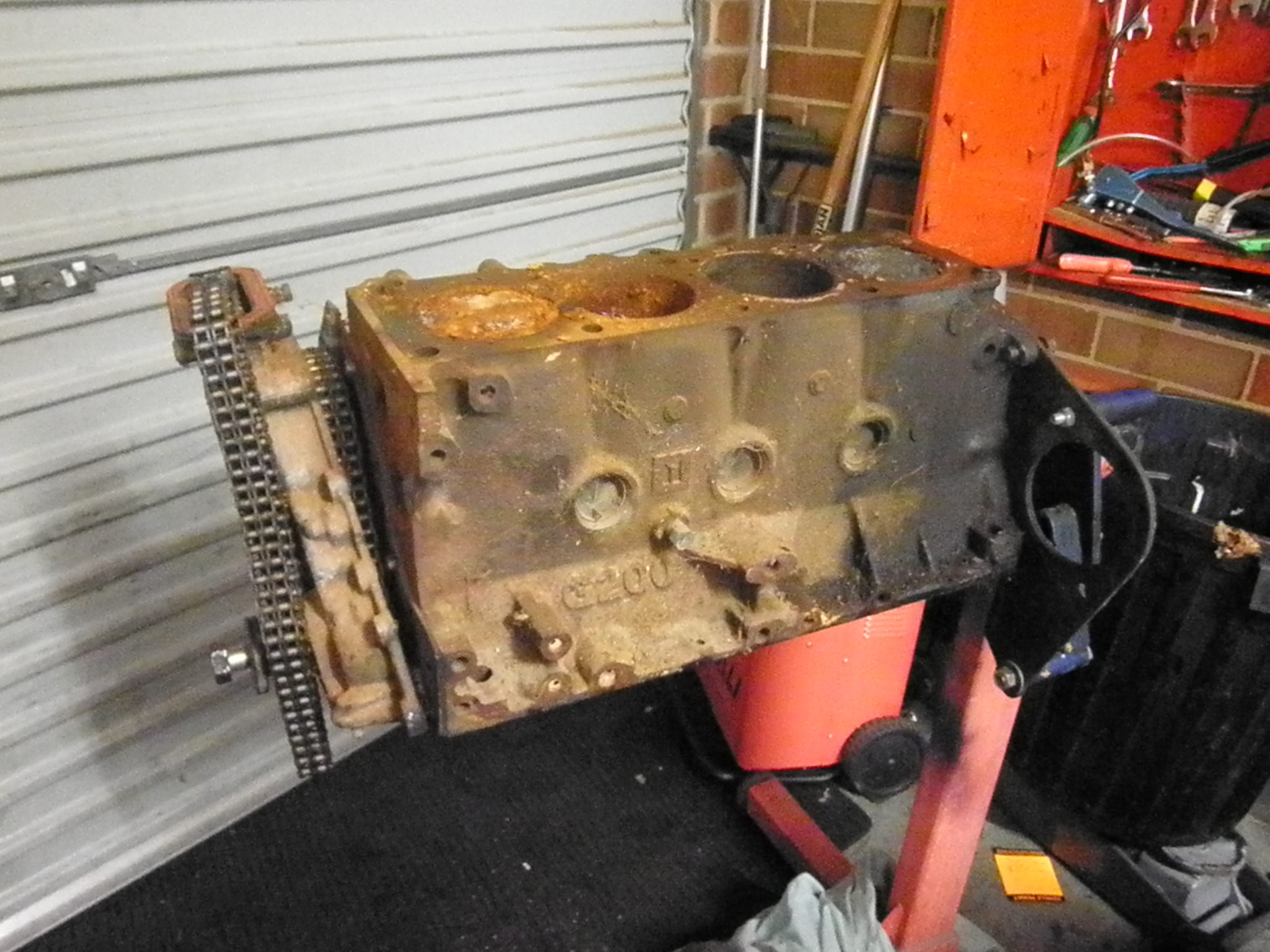

Striped the g200. Not good like the florian . Big ends little ends shot crank damaged. Bore damaged going to need a lot of work . Unless I find something major at the machine shop I still intend to rebuild it. Gricey

BLOCK IS IN THE MACHINE SHOP . I THINK IT NEEDS WORK . GRICEY
