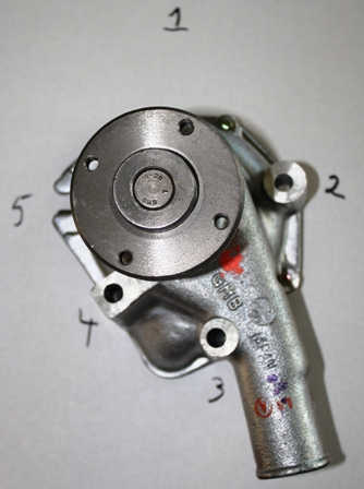

Waterpump off of 72 Luv for use on Bellett's
Posts: 36
It has been suggested that a waterpump of a Chevy Luv 1972 could fit onto a Bellett.
The LUV pumps are still available here in the US.
I had a request from oz_toffa who wants to try this out.
I ordered one and took some pictures which I will post here for a comparison.
Most of the bolt holes seem to match up and the actual pump housing is a very similar shape.
The outlet is in a very different place, but I would think a flexible hose would work.
I will leave it up to oz to actually try and fit it on.
I'll see how adept I am at loading up the pictures here.

Posts: 36
Here is the LUV pump. (Bomba de LUV in spanish, has a nice sound to it :)
Note the direction of the outlet.
Also note that hole 1 does not exist.
That may be the real sticky point, but I think it could fit still.
File comment: New pump for 72 LUV
Doug Hillmer
Sun Aug 19, 2012 11:54 pm
