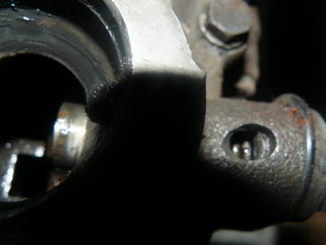

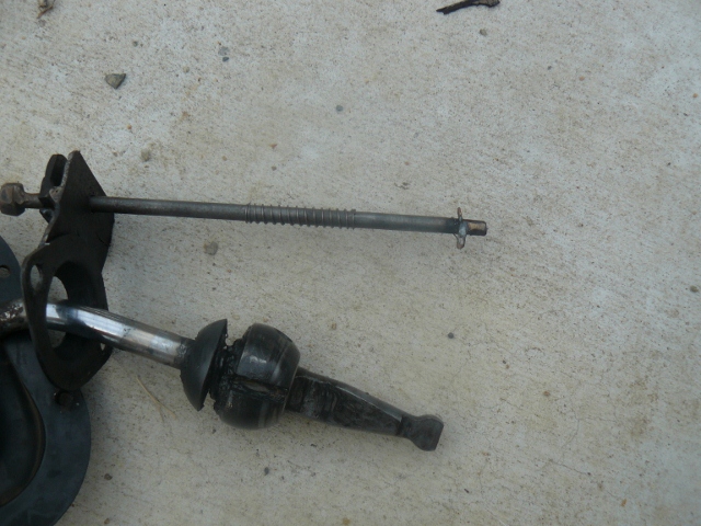

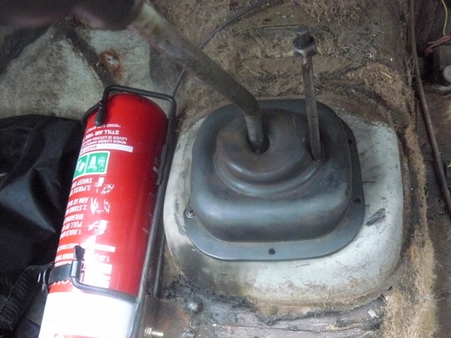

Gav it's easy to make.
take the gear stick out 2 bolts then the next lot 4 bolts of the box, now the 2 bolt flange weld a plate to the side of the flange that sits over the detent for reverse, now take the big nut of the end on the detent case the spring will want to come out let it then the pin you can see down the hole push the pin in hard and mark it drill a hole so if you put a rod in the hole the pin cant come back this will stop the stick coming back. The round rod thickness mine are around 4mm so a mmhole was drilled put the spring and bolt back in place.
Put the rod down the hole it will hit the spring only in a couple of mm put a flat washer over the rod and let it sit on the alloy housing and tack it to the rod, all done. reassemble the 4 bolt to the gearbox and the stick a hole needs to be drilled inline with the hole in the housing now put a compression spring over the rod between the plate and washer now put he stick back in.
i will put photo's on in a little while this sounds hard :lol: but it's 1 hrs to do it.
Wed Apr 25, 2012 6:47 am
here are some picks

That is very very clever. It is not some thing I had ever thought about doing until you mentioned it. When I pull the heater out and get the rubber matt out of the front I will do it. Cheers
