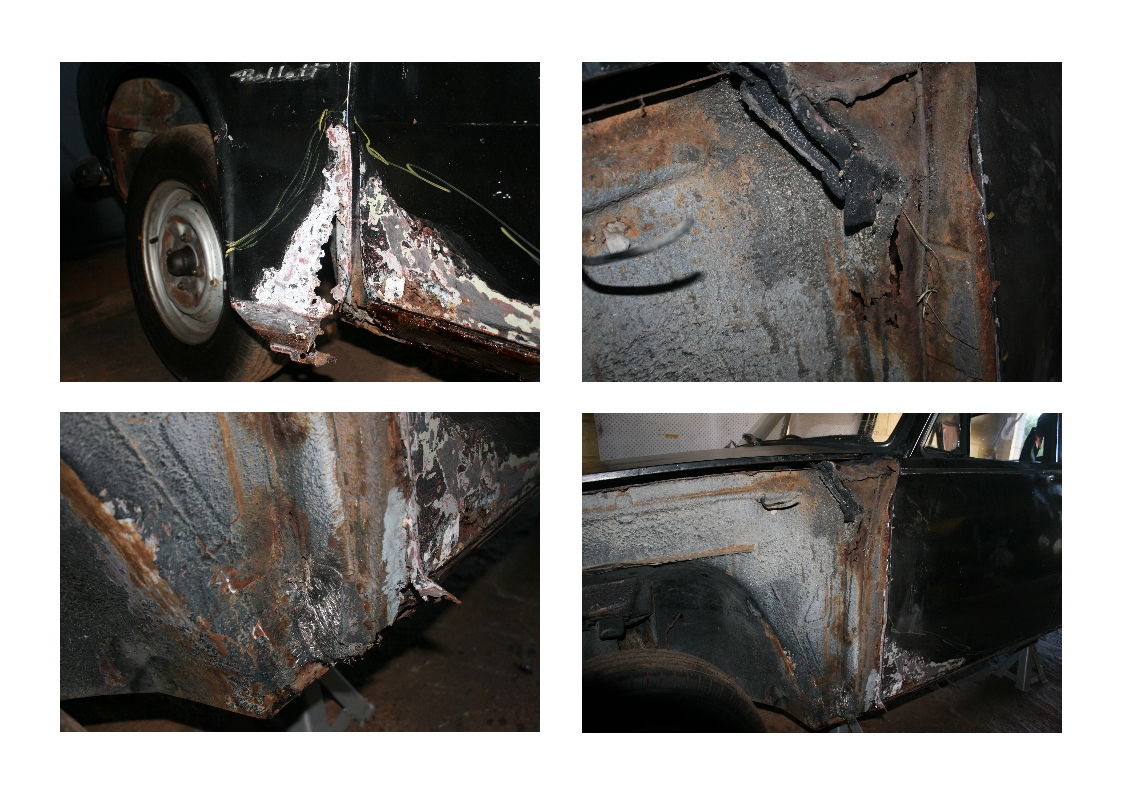

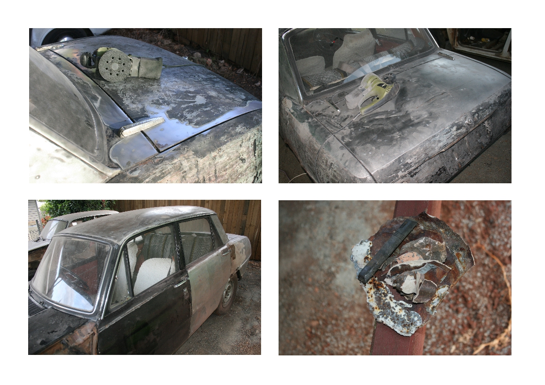

Thought a bit of an update might be in order, just a wee bit worse than expected, but we have come this far, no stopping now.
Ted Freeman
Wed Nov 09, 2016 8:59 am
Yeah, that is a bit of a collection of rusty bits. It looked so good, but no doubt plenty of cars have patched over rust. Glad the price was right, softens the blow a bit.
Good on you for getting stuck into it. You will have a nice car before too long.
