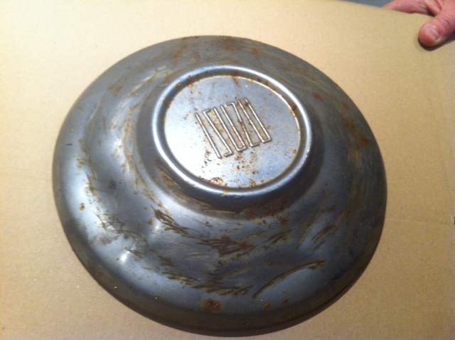

Not sure ,but I think they are standard hubcaps ? I have shown the worst one.
I also have a '67 Bellett ,and the hubcaps are the same ,but some of those have a slightly sharper outside edge on them,so looks like there may be 2 types .

they are standard Bellett hubcaps. the deluxe ones are a full cover car and much fancier.

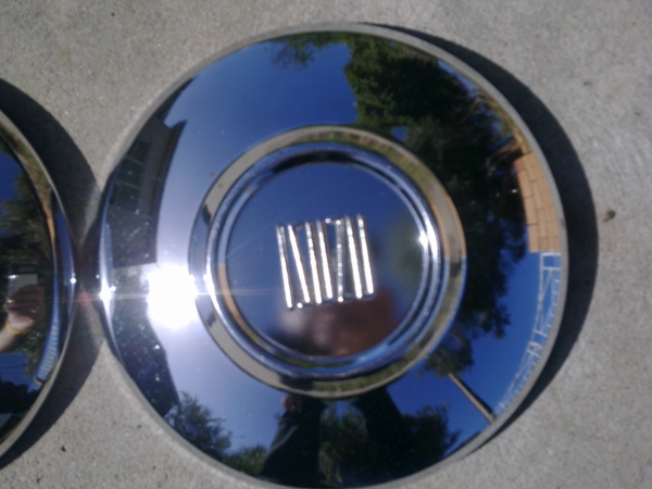

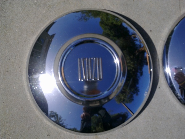

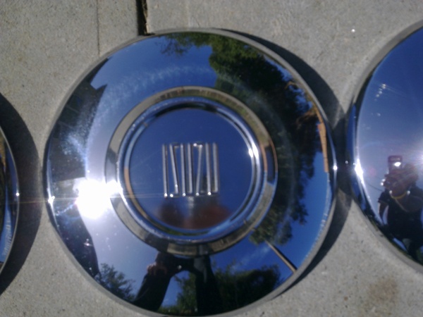

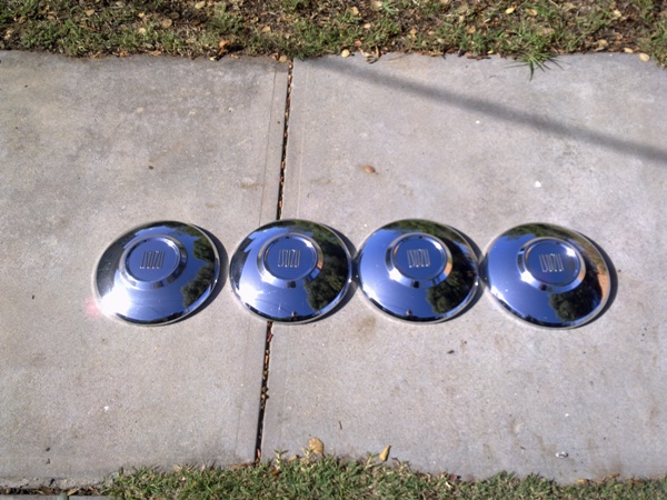

I have 4 of these -- been stored in the shed since 1979 when I replaced with mags
Not in bad nick
PM me if interested

nice one .....just what the man needs .... lets get all these little cars up and about my caps would be a waste of a photo after looking at these cheers davo
