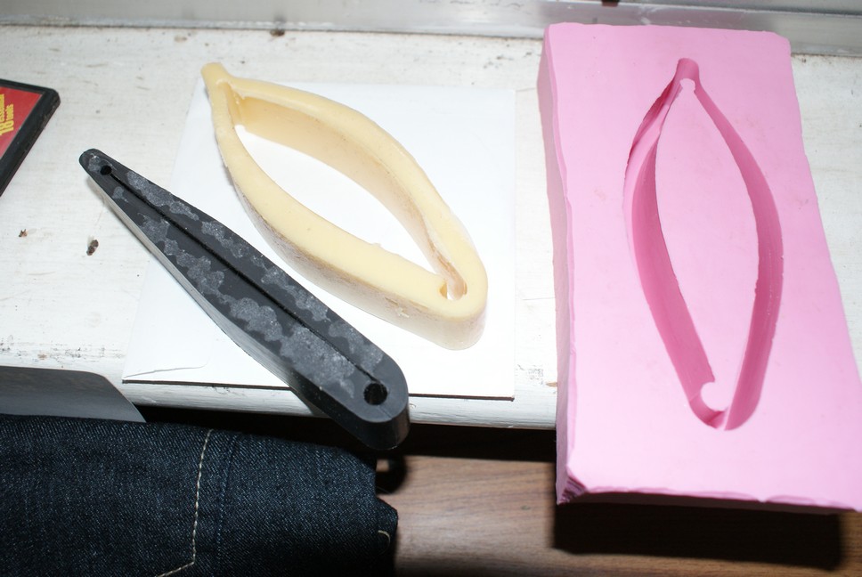

here are some pics of the first effort. Not quite warm enough for Urethane to go off as per the supplier but i am going to fit this to my auto engine that needs a lower engine re-fit.

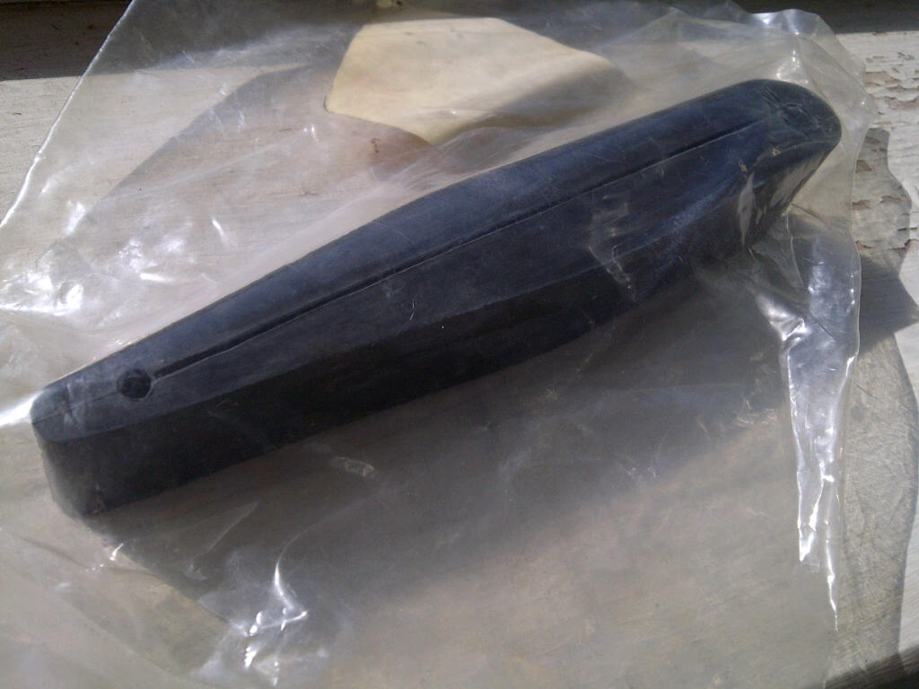

It looks a lot different out of the plastic bag. So the side rides against the chain, not the top face.
It might be closer with a metal center wall with straight sides and the circle at the end. The curved walls to keep the mold stronger might not pull flat when the piece is installed.
This is one where measuring from the piece it fits onto is important for the inside dimensions.

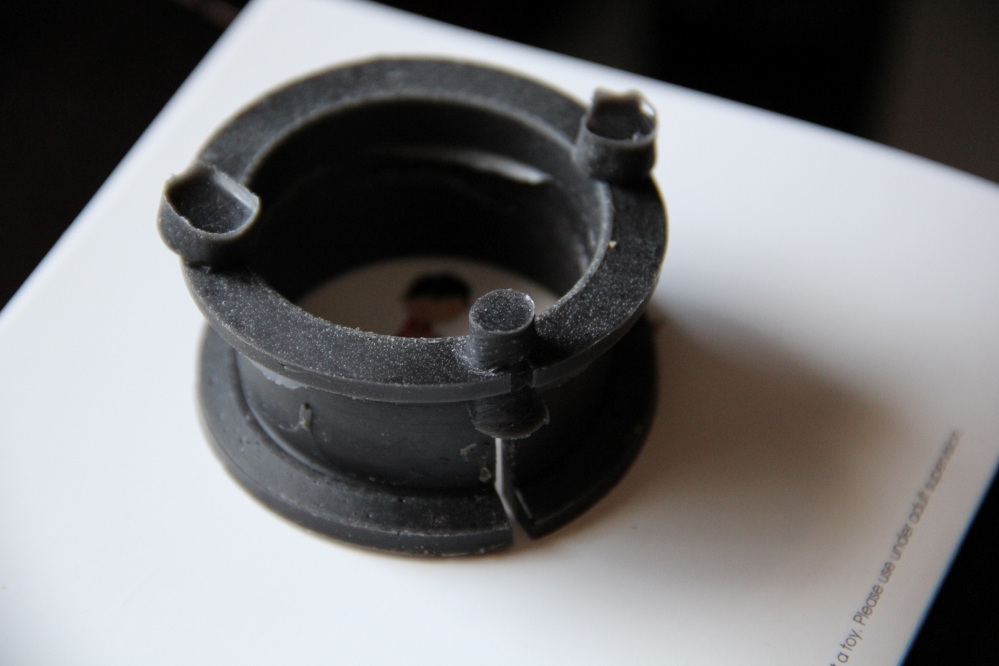

The new world order may just have arrived...anyone want me to reverse engineer something for them?
http://www.shapeways.com/
Could always give it a shot and find out. For those who don't know my background (erm, maybe Oz does, but certainly no-one else), I'm an Industrial Designer with about 20 years manufacturing experience, I also have my own SolidWorks CAD licence and work freelance after hours (possibly permanently if things go crap at work). I'm not sure if 3D printing will be useful in this case, but there's probably quite a few areas where it is...certainly beats casting!

The system scans the original, allows the computer model to be manipulated, and then makes a prototype piece using a 3D printer.
But it is a prototype, not a finished product, unless you need a finished product made out of a substance that is like the stuff you load into a hot glue gun. It's like plastic, the "printer" melts it and deposits it on the thing it is printing, like making little dollops with a tiny glue gun. Great for rough fitting and getting the overall shape worked out, not so good for things requiring a precision .00X inch clearance. And not so goof for things that need to be made out of steel, polyurethane, etc.
The shapeway's website shows some different materials, including a "bronze impregnated stainless steel" (?), at $8.00 per cubic centimeter. But no details on how these materials are run through the machine, or maybe they take the 3D file and outsource the job to a machine shop. One or two of the other materials are priced per square centimeter, so they have to be flat, not 3D.
It might be great for making investment forms for pour casting.
So what happens when you want something out of a specific alloy so it can be tempered or heat treated to make it strong enough to do what you want it to do? Or a material that needs to be a solid piece that will not separate at the seams of the little dollops? Or something that can't be melted and run through a little nozzle?
And the steering rack piece looks pretty good, and maybe oz_toffa has been understating his polymer casting experience.
