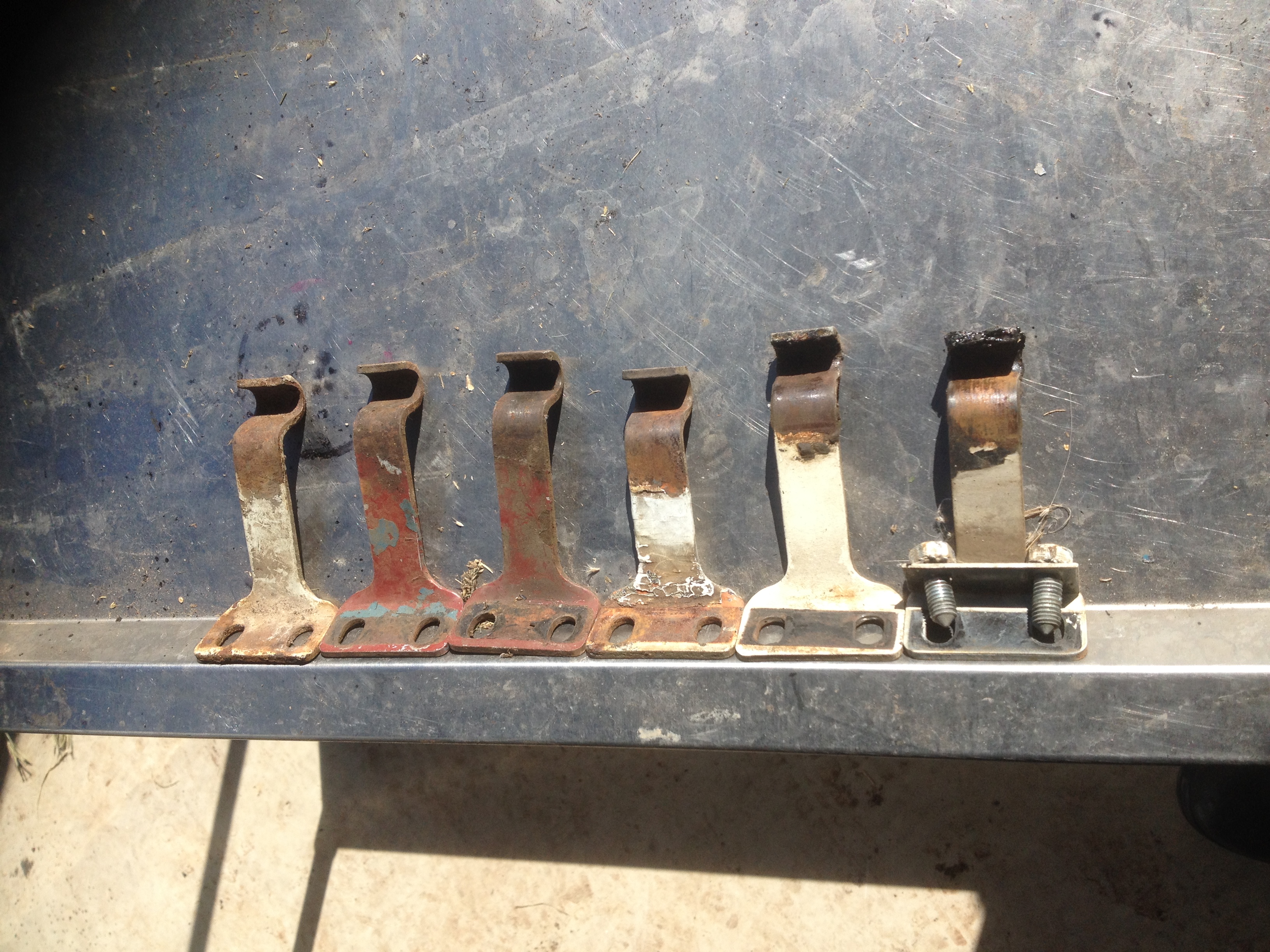

I was looking for some straps for Blackie when;
Thought I'd confuse the issue a little more
The two straps nearest the end with the bolts are definitely off the sport. Yes one is short the other is long. Not sure which side each came off. Anyway the other four are from spares lurking around the shed from Peter A.
Could be how much you want the door to open?? :?:

Hi Dean
the length varies according to the door i believe GT or sedan. Just wh\y i am unsure. Maybe the pin location on a GT door is different....
can u spare one of the longer ones ?
these sometimes break (as mine is) over time. The hook end just snaps off. Could be why they vary, as replaced with a sedan type.
address on pm. Many thanks Dean.

but why would there be two different lengths on the one sport? Weird.
