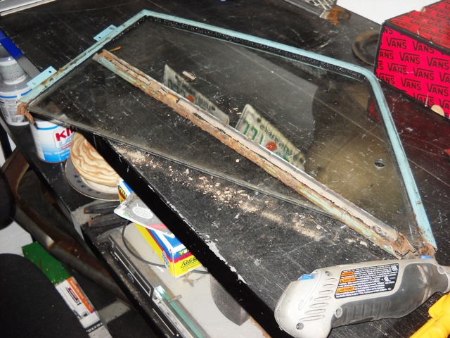

Man, the windows couldn't be ignored; tooo much rust (sorry) it's got to go, poor thing's been through a sand storm ...
I didnt have a wood vise though ... :shock: we did manage however to get it all apart.... :P
Those brackets would be helpful, I'll pm ...
