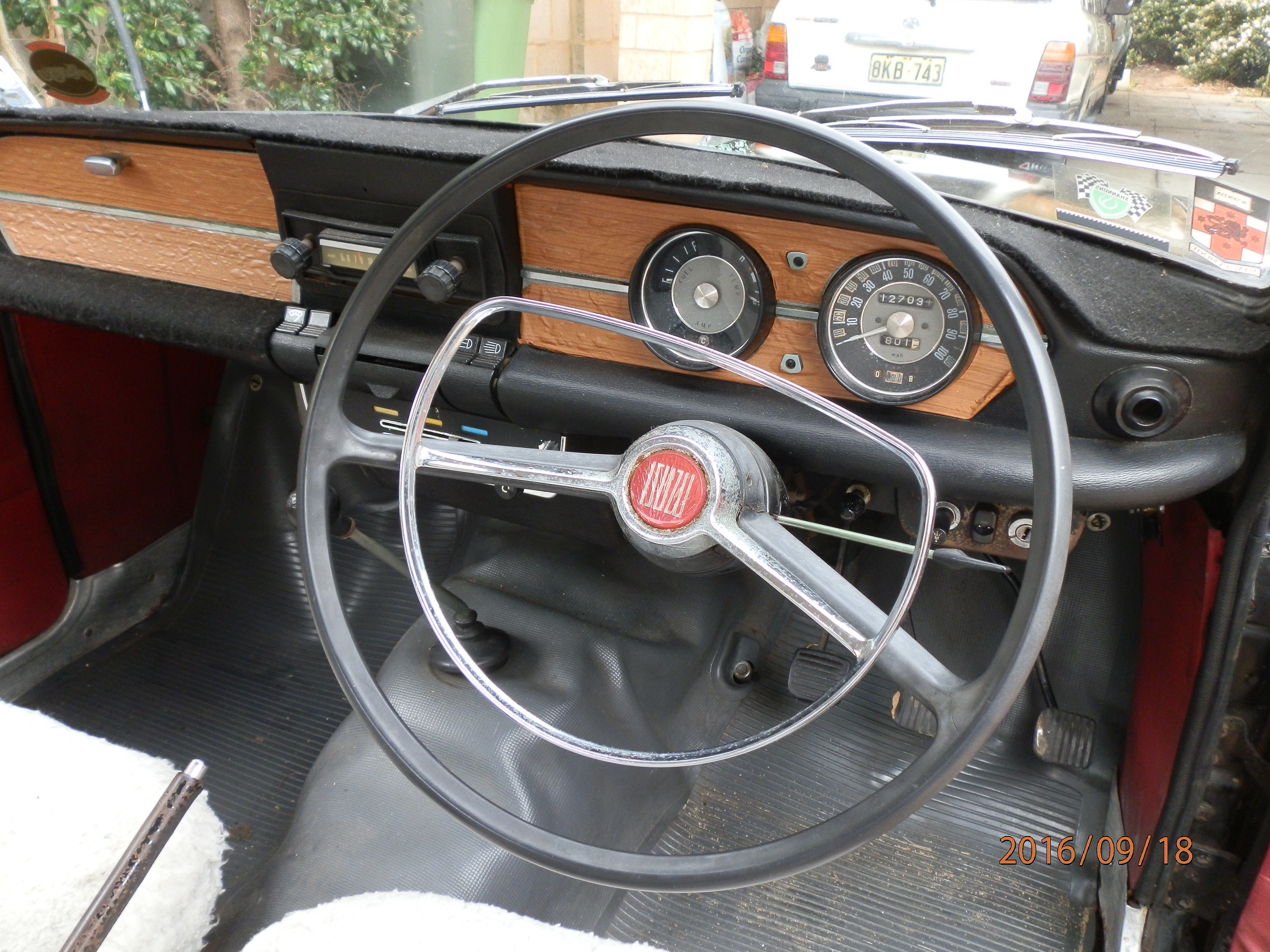

1967/68 Bellett sedan For Sale

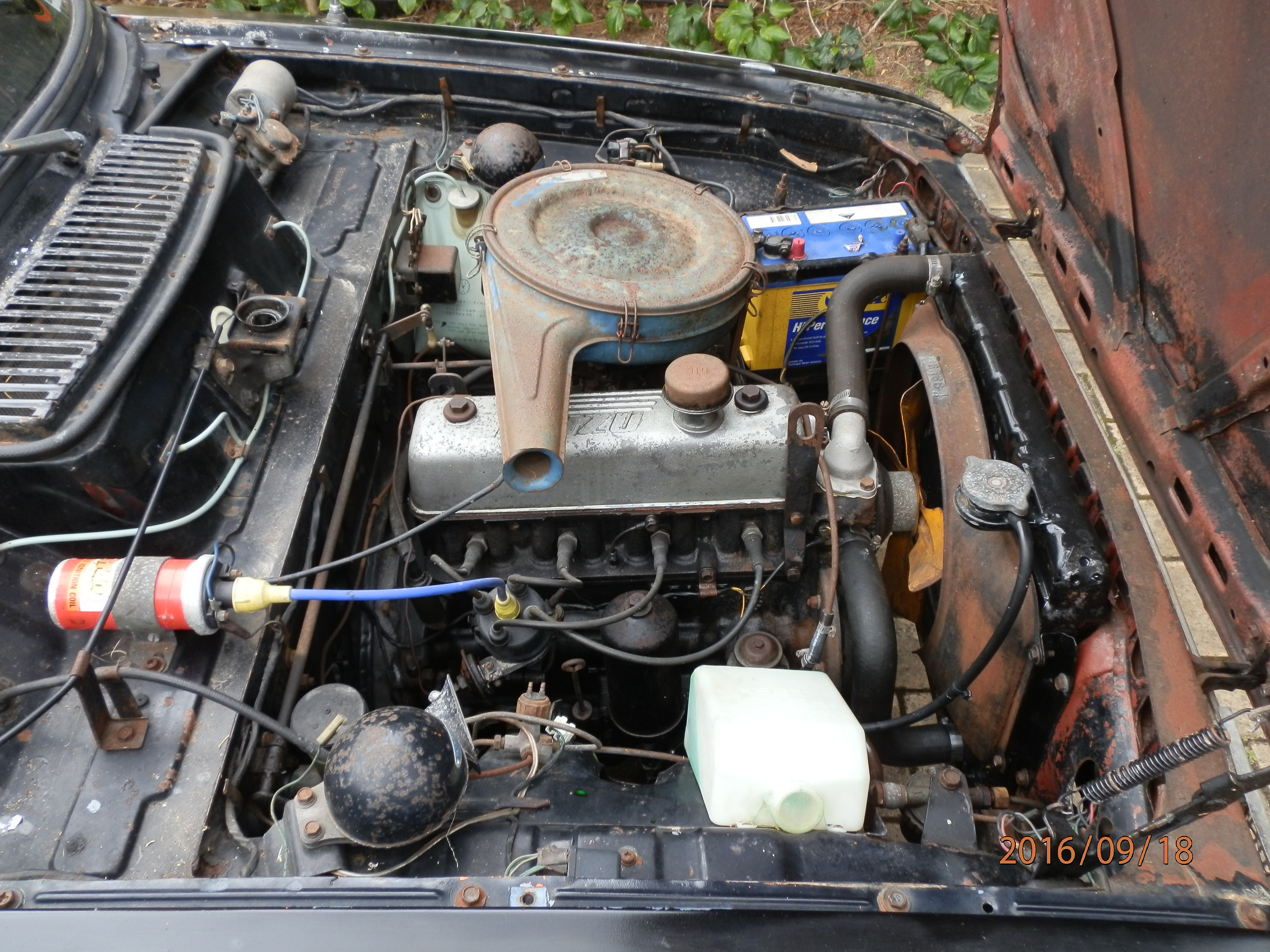

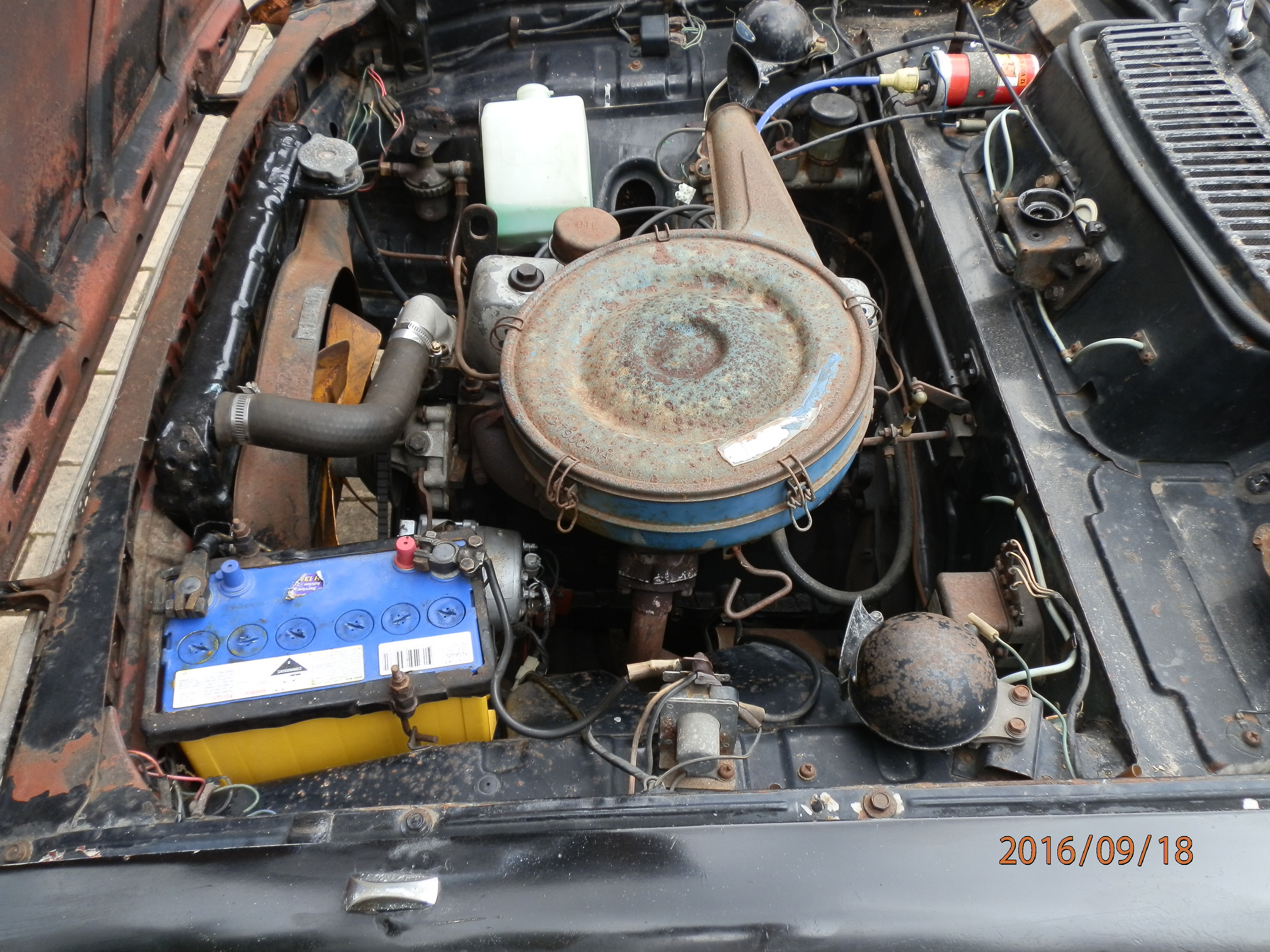

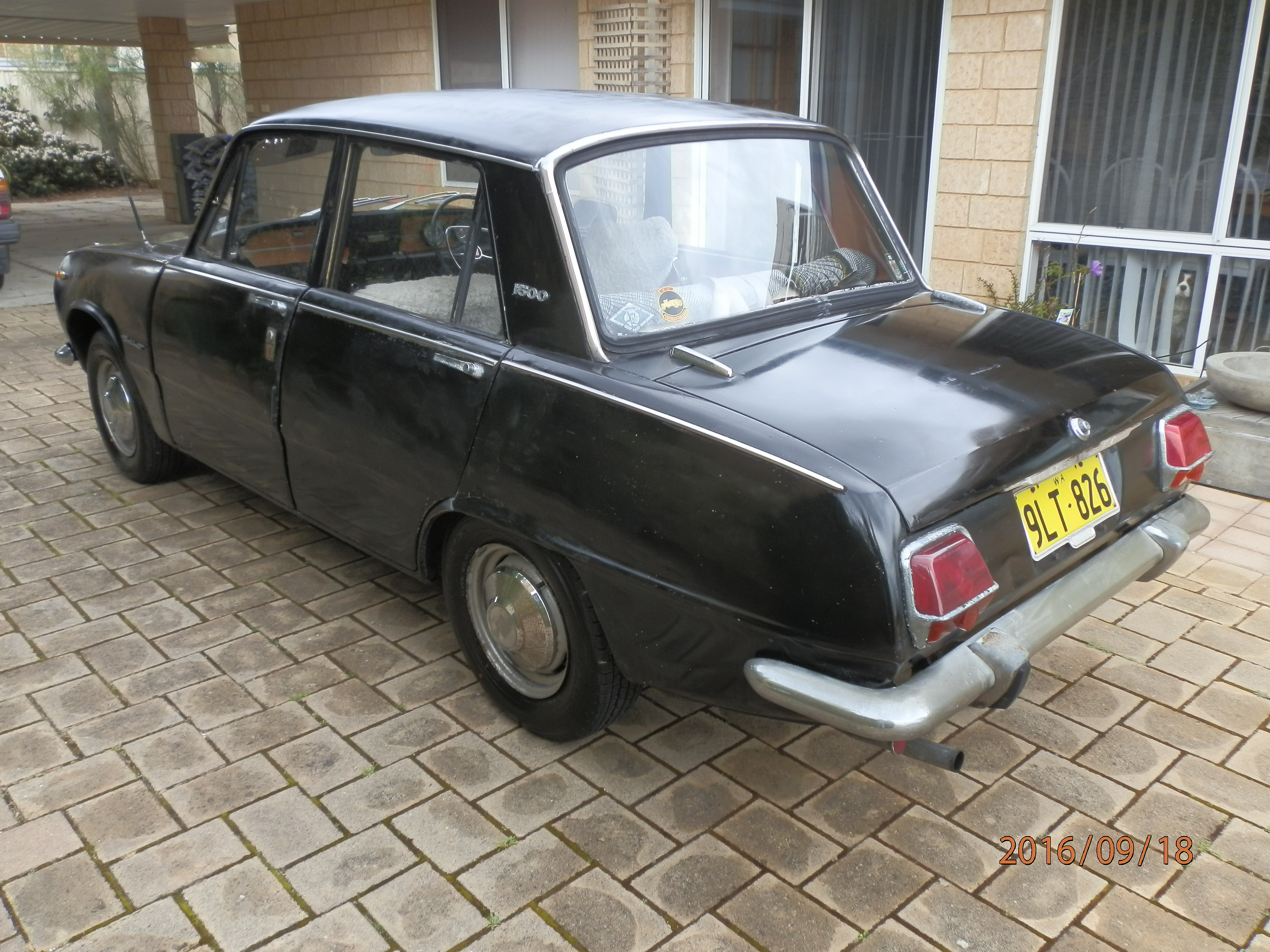

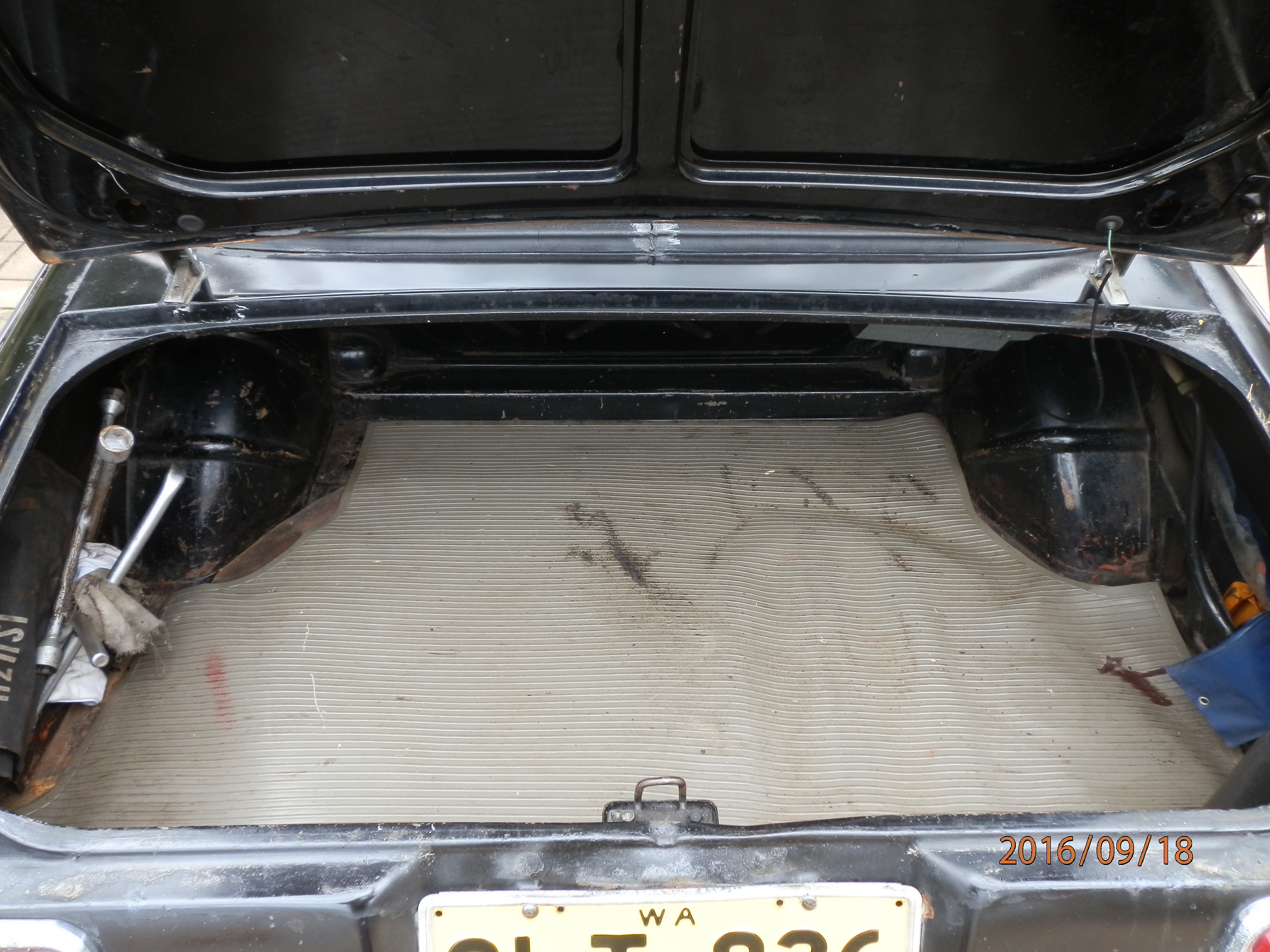

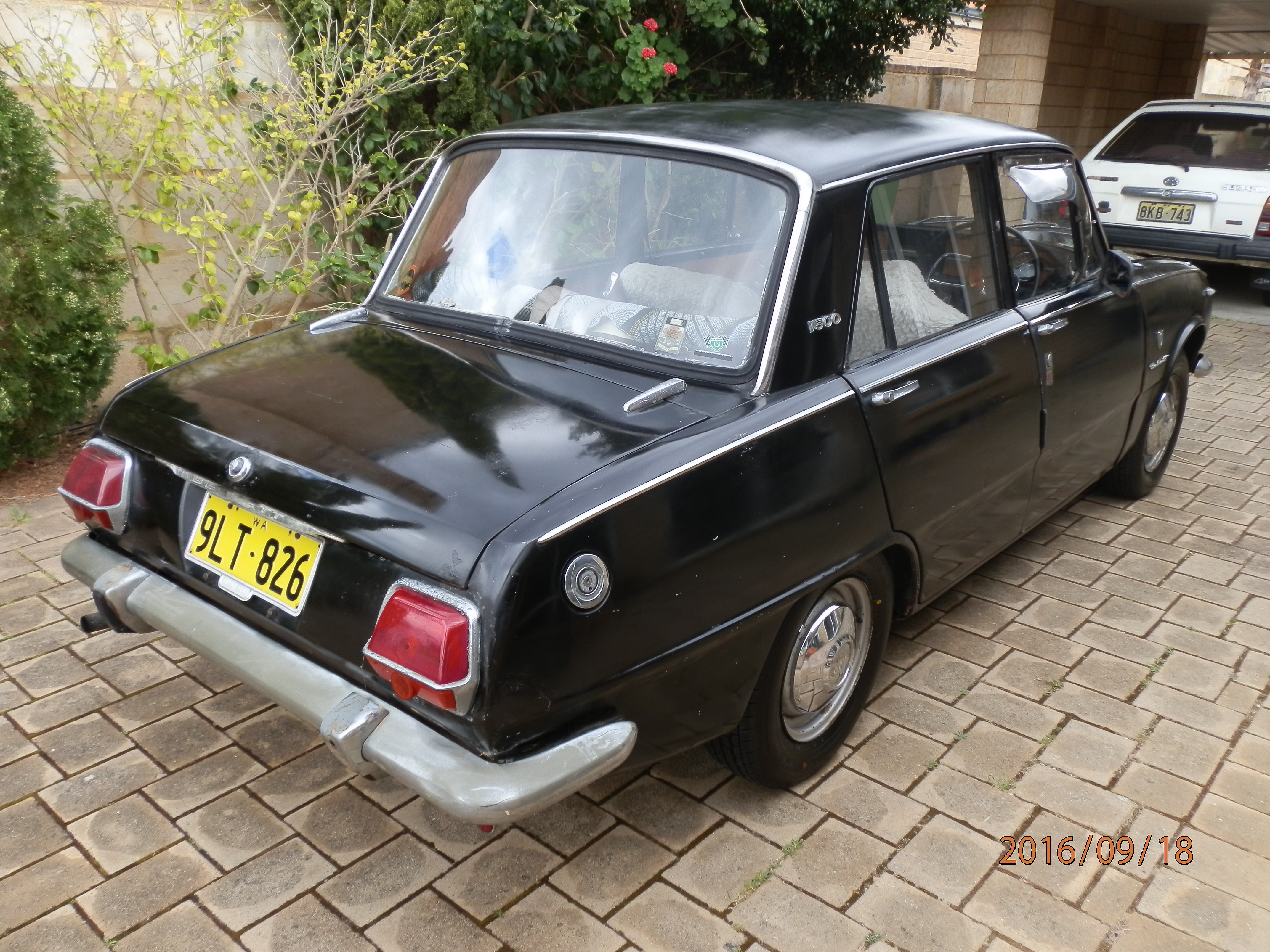

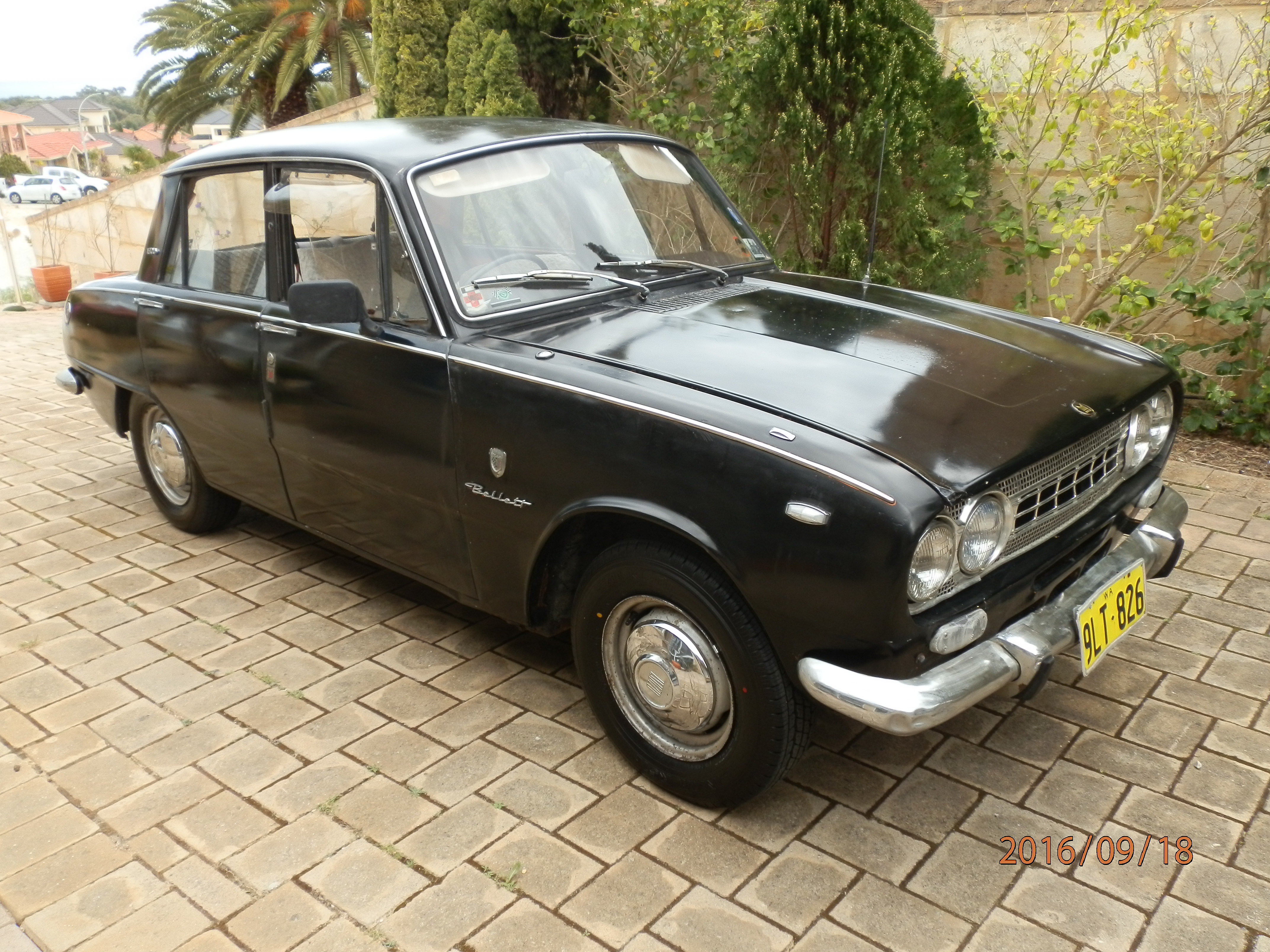

The owner contacted me as he would like the car saved, however the car resides in WA! :(
The owner has had the car from almost new, photos attached, mobile number 0478 833048. The owner knows of the cost to transport the car to the East and will take that into consideration for anyone who is interested! Who knows, it could be a freebee IF you pay all transport costs? ;)
Would be great if another can be saved as the current owner wishes.
The motor was rebuilt at just under 100,000 miles and has done 12,000 miles since the reconditioning. :)

shame the distance ...should be some belletters over there its I think pr20 4080888 year ??
Wed Sep 21, 2016 7:28 am
I enlarged the photo and reckon the number is 4050888 which is 65.5, 4080888 would be 67.
Also i reckon that its a 3 bearing main engine, Low starter motor, alloy rocker cover but no breather or bolts which is consistent with late 65.

Hey not wanting to pick faults
are my eyes crossed or is that fan a bit wonkie?
Well it is a long drive across the Nullarbor

from the drivers side looks like the tips are bent
from the pasengers side looks ok
:lol: optical allusion

The owner said it has a 5 bearing motor, however he has a spare 3 bearing motor plus other parts to go with the deal.
The body is definitely late 1966 on, OR major body work has been done but not according to the owner, a senior chap.
I think the chassis number looks like a 408 number to me!

No matter what.....its black!!
With the right set of wheels would make a stunning sedan B-)

Yeah, fan looks pretty wonky, but I've got plenty of fans! What I don't have (any more) is a factory black sedan!
