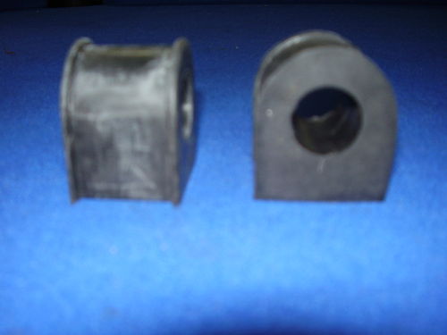

original on the left, home made Urethane on the right
Sat Jun 02, 2012 6:34 am
great job done there mate .....who can tell the difference .......cheers davo
Sat Jun 02, 2012 6:37 am
nice work oztoffa they look good!
