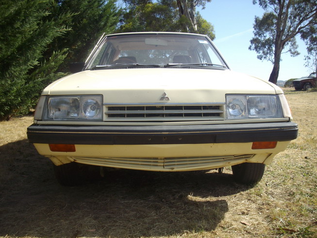

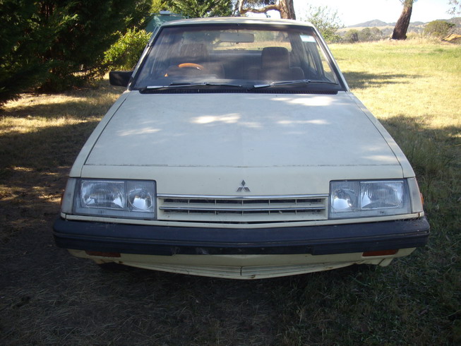

See, I call in every now & then to see what he's found. There is all kinds of treasure, usually in the form of old trucks. So we walk along the line and Dave says, "This one's probably too good to crush........"
Starts, drives, everything works, upholstery perfect..........even has air-con. 93,000km, and the speedo IS working!
Yep, it's a Sigma...........
'84 - probably the last model?
So, whats wrong with it?
Well, one tyre is peeling, and its outa fuel........and the radio is gone.
$400? It's coming home with me. :)

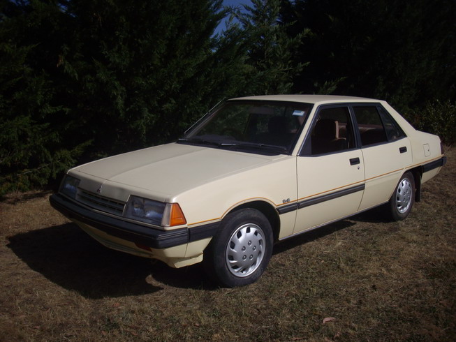

The short drive home reveals temp guage not working - the wire was off. And that flapping tread is a bit anoying. The spare was flat, but I pumped it up & it held, so that replaced the wrecked one. Bonus, the Florian wheels fit, & I've got a couple of good spares.
It's crusty with mould from sitting out, and theres no shortage of filth inside, so a good clean is next.
Saved.

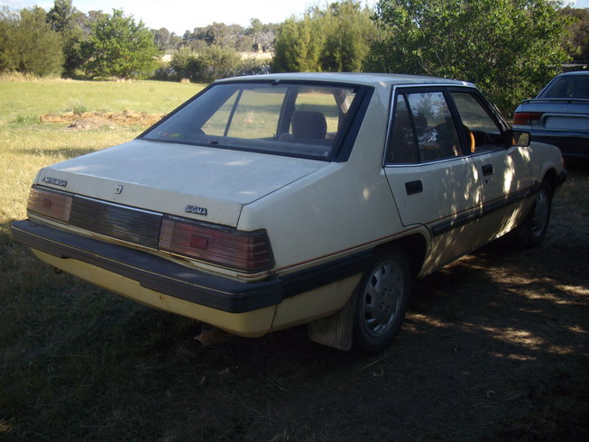

Thanks fellas, :o to see no howls of "you bought a WHAT??"
It is the 2.6 and a 5 speed. It's surprisingly toey, but I suppose its like a Florian with an extra litre and gear! Motor is quiet & pretty clean - no fumes.
Rhys gave it a scrub with truckwash & a microfibre cloth, and its a lot better.

I think it might even be smileing!?
Checked the brakes - plenty of meat. Handbrake 2 clicks & wheels skid. (Back drums :) )
2 good tyres.
Carpet as new, seats too. 1 small dash crack.
Needs: 1 Tie rod end, leak in radiator top tank fixing, maybe shocks. I think thats it.
At worst its a learn-a-manual for the kids. Might be good enough for a Rhys first car? If not, eligable for historic rego in 18 months. Its simple tech with a Carbie, rear drive, and a shop manual is 10 bucks on ebay. Cheap & cheerful!

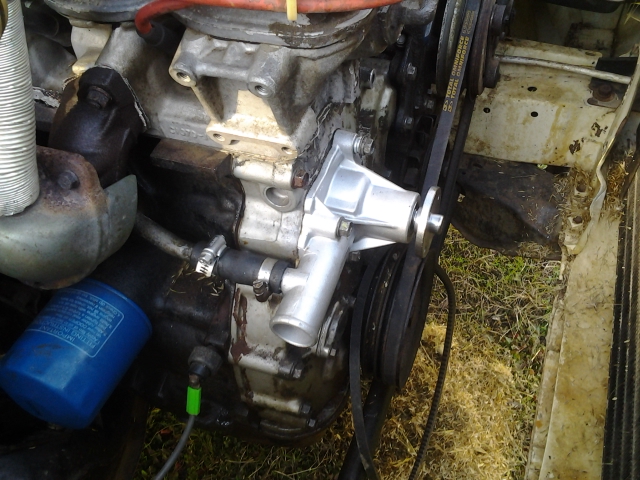

Well, she is getting some love now, from Rhys. We havent found anything better, so might as well put it on the road.
Step 1: Nice shiny new water pump. In stock in Autopro $80. Have already swapped the radiator, $50 from Young wreckers. Fitted a manual choke to the carbie, someone had removed the auto setup.
Might be some life left!

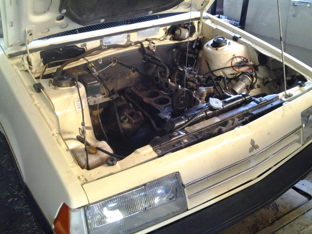

Six months ago we finally put it on the road. That used radiator ended up leaking, so I got one off the shelf from the rad place in Canberra of $250 with a new core. A couple of good tyres and its away.
Looking back here I see it had 93000ks. Now it has 96000, so Rhys did about 3000 ks of learning in the paddock over the 3 years!
Soof course, it soon started blowing bubbles jn the radiator so, off with its head!
The back 4 head bolts were loose, so it was probably never retensioned after its last gasket replacement.
A vrs kit from ebay for $50 delivered and its back together. Drives a lot better!
