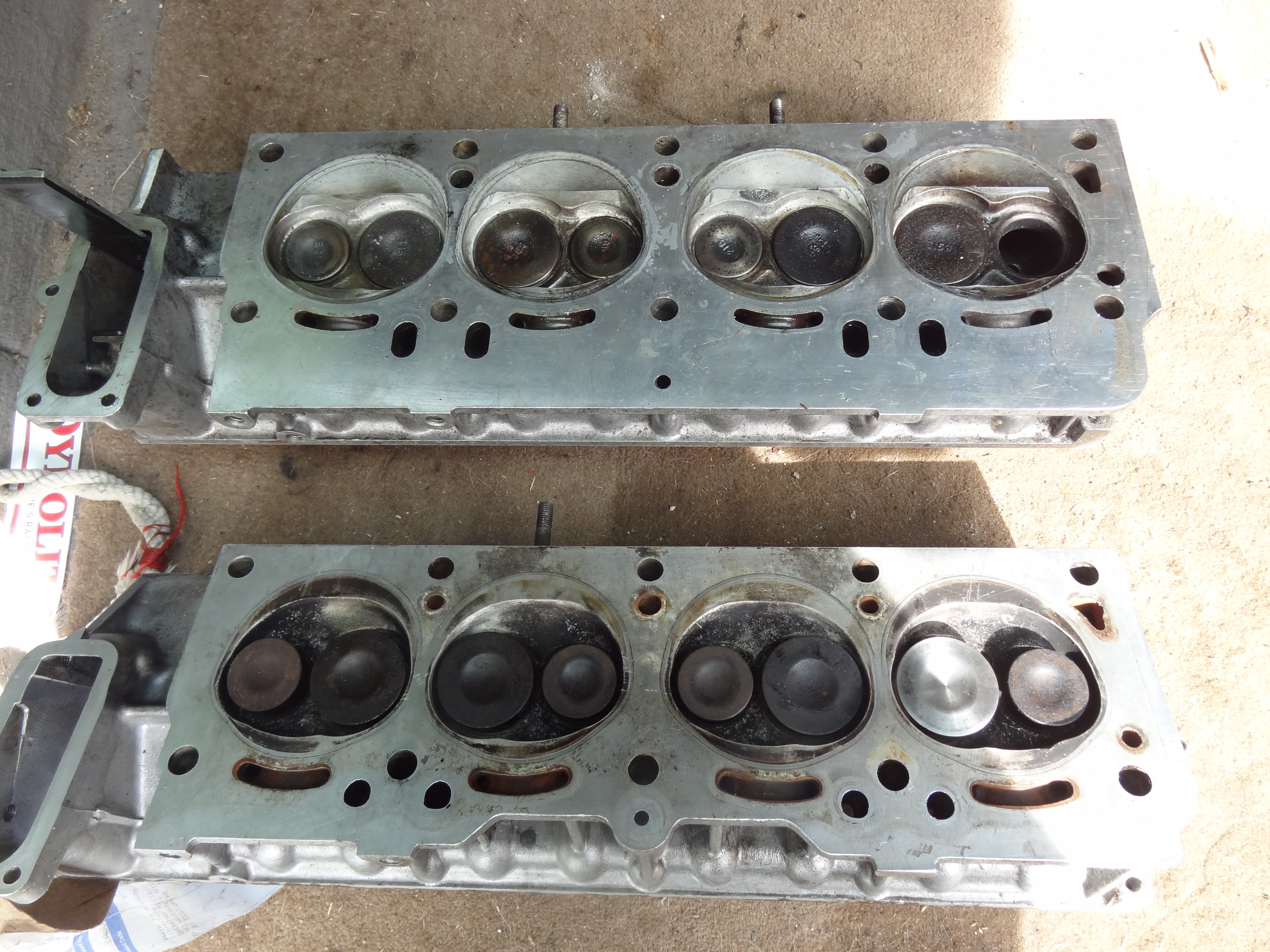

Well, the 1600 head has gone onto the 1800 block..and our Frankenstein engine is taking shape. The theory behind this strange hybrid, is that the smaller combustion chamber of the 1600 will give us more of our much sought after compression. Top is 1600 above the 1800.
We calculate we'll get somewhere around 10.5 - 10.6 : 1

Posts: 259
Car(s): 1967 GT Bellett
Hi Mark
The 1600 head looks like a better shape than the salad bowl 1800
Is it an optical illusion or are the 1800 valves bigger?
Regards Flying
Mon Jun 22, 2020 10:46 am
Posts: 490
From memory the 1800's valves are marginally bigger....but rather annoyingly they are also a couple mm longer.
