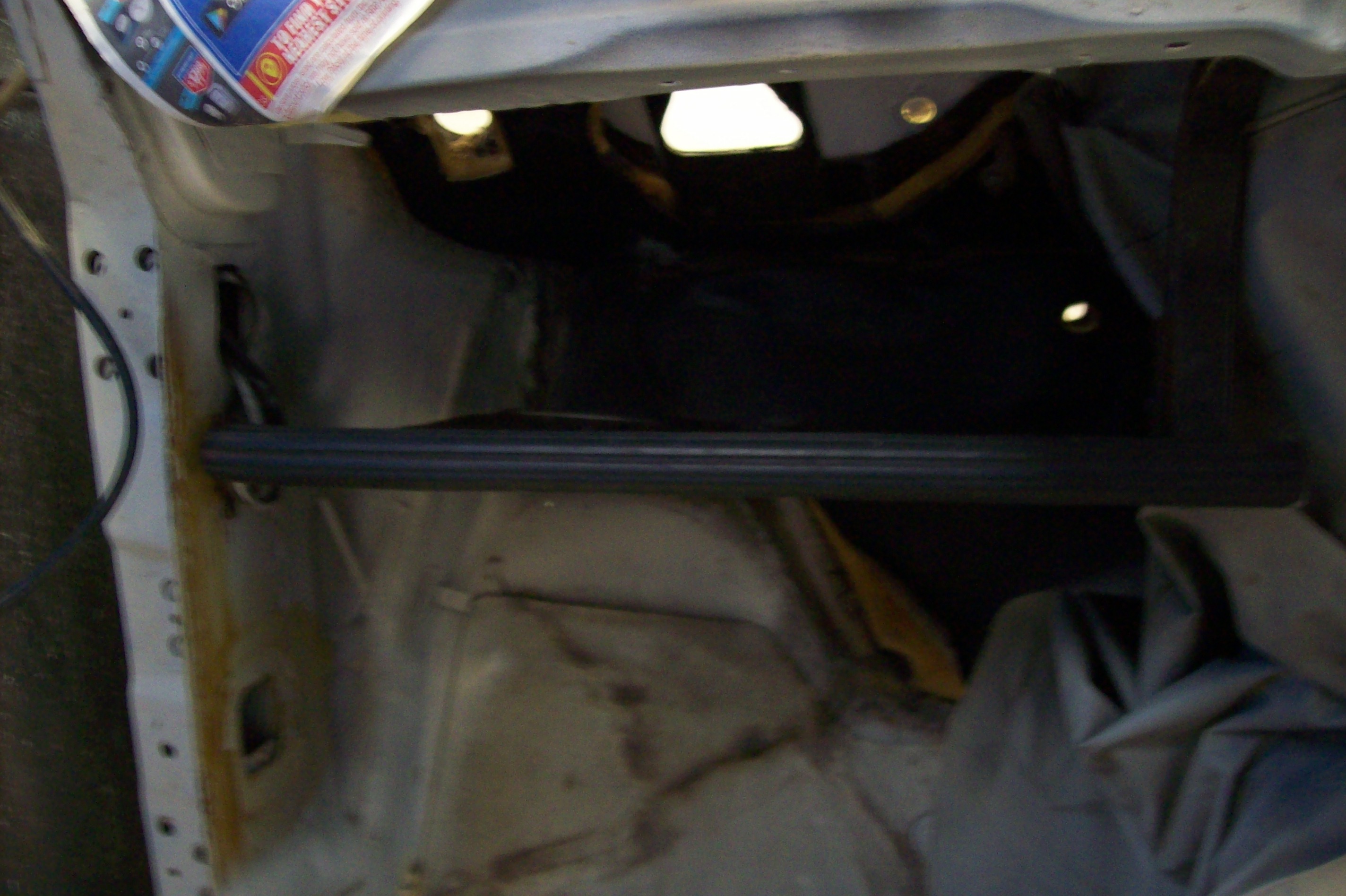

Hi
During Lock down i have found some tome to fiddle
I removed the Centre console and then removed the Heat Exchanger which just fed the windscreen and side vents.
I had some heaters in the shed that included the 2 speed fan and dual slide controls
Does anyone have a good rubber that goes between the fan unit and upper vent as mine is very ordinary. It goes from the oval shape into a circle. My guess would be that its in the unobtainable realm
Regards Flying
File comment: whats fitted now
File comment: parts found
File comment: originally in car

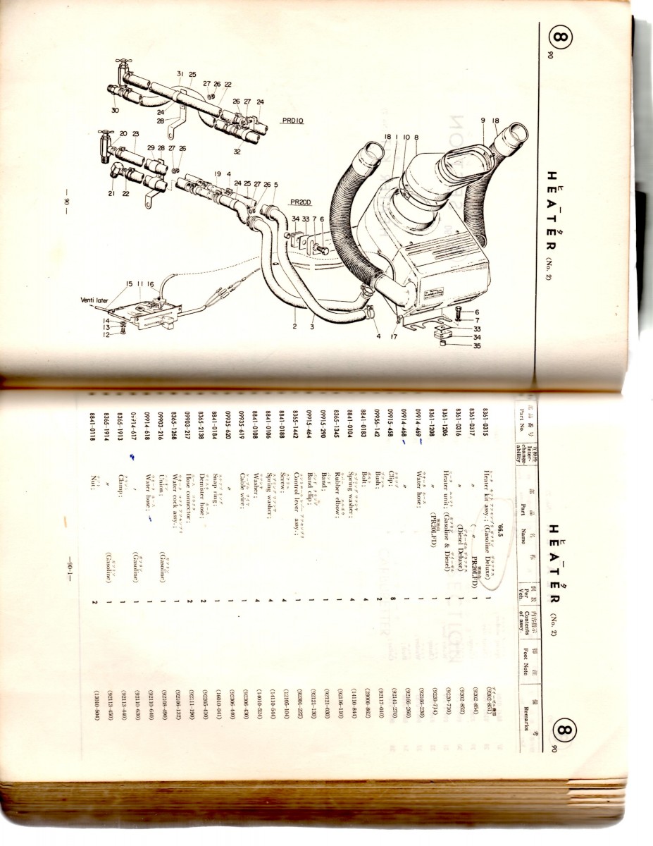

Fri Jul 30, 2021 8:42 am
I was wondering if the South Australia importer had GT's come in without the factory heater and fitted an accessory type just to keep costs down.
The heat exchanger is the same as my white GT and it's from South Australia. I mentioned before in this post that my first
car I fitted a Smiths' heater not to similar to the above picture and without the box.
I cannot find in all my parts catalogues that exchange unit. But. There is a listing for heater kits for up to 1966 and then from 1967.
The importer imported the vehicles less the heater from factory and as an option to the buyer a heater will be fitted as an accessory. And the buyer does not know that the heater is not the same as the factory unit. Woops. :o
Like I mentioned. Just wondering.
And if your thinking that the hose that Flying has shown must be an afterthought. Oval to round. ????.
Diesel Kiki had the contract to supply the heaters to Isuzu. Just looking at the diagrams in the parts catalogues shows the early vehicles had a rubber round elbow between the plenum inlet and the heater. Isuzu changed the inlet to oval and Diesel Kiki didn't want to change their tooling so they came up with the oval to round elbow. Which is a part of the vehicle when disturbed splits or fall to bits. I'll try to upload the parts listing to show you what I'm referring to.
Sat Jul 31, 2021 12:12 pm
Parts listing for heaters. As you can see the difference between the early duct hose and the late.
File comment: Early heater unit.
