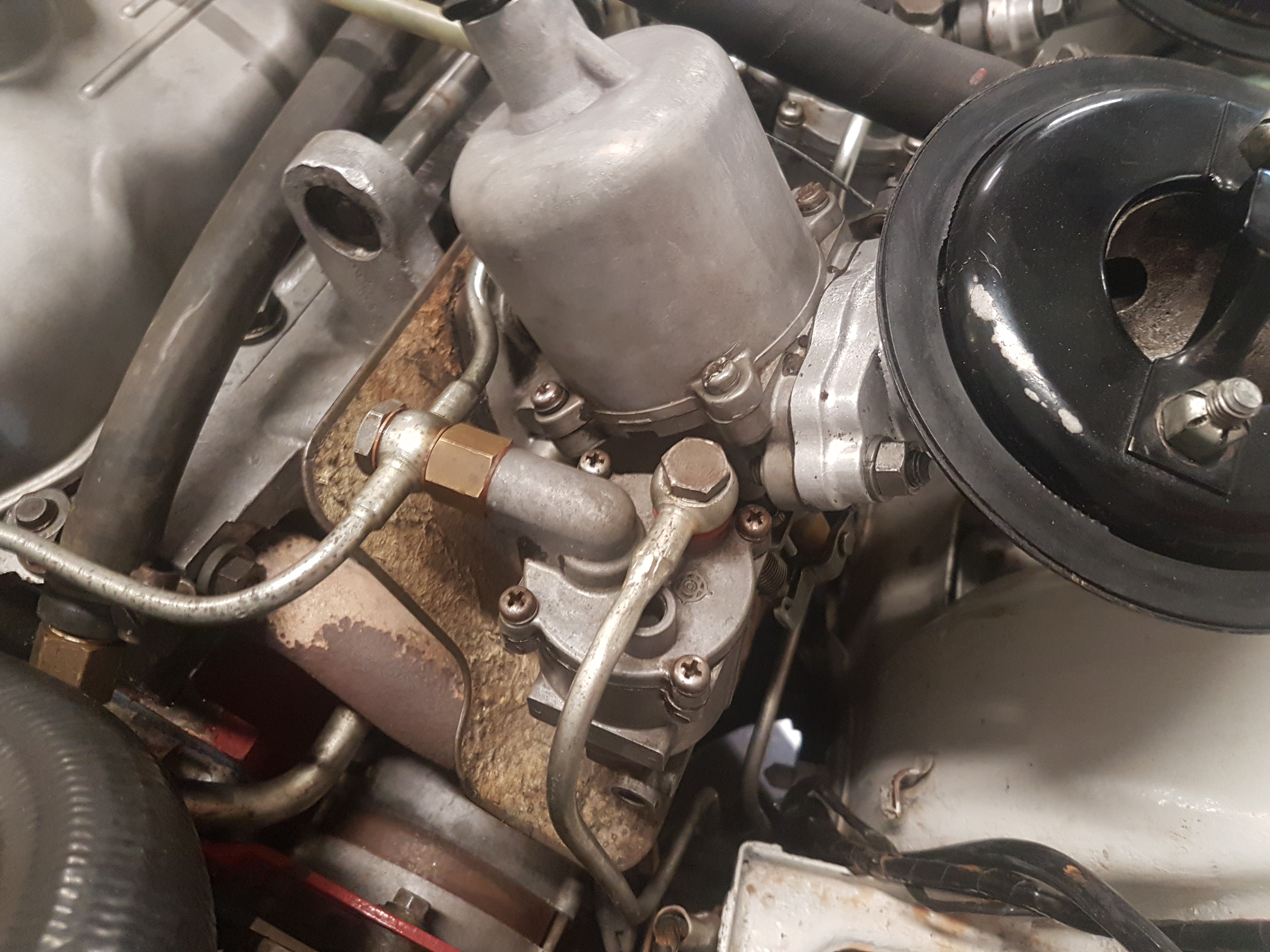

Here are a couple more "carby pics" (1967 PR91 Bellett GT) for your info. /reference .

I forgot to say that the "bowl overflow" pipes run down to near the "cross member, steering rack ..." and empty onto the ground......(I think maybe (going by a fuzzy original Sale Brochure picture) there was a short length of hose on the bottom of the pipe originally (I maybe wrong...)
