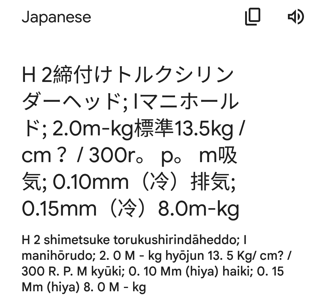

I scanned a section of my PR60 owners handbook with a Japanese to English translate Ap.
While I had no doubt of Dicks info, it was neat to try the scan and see what it did. (google translate Ap on my phone)

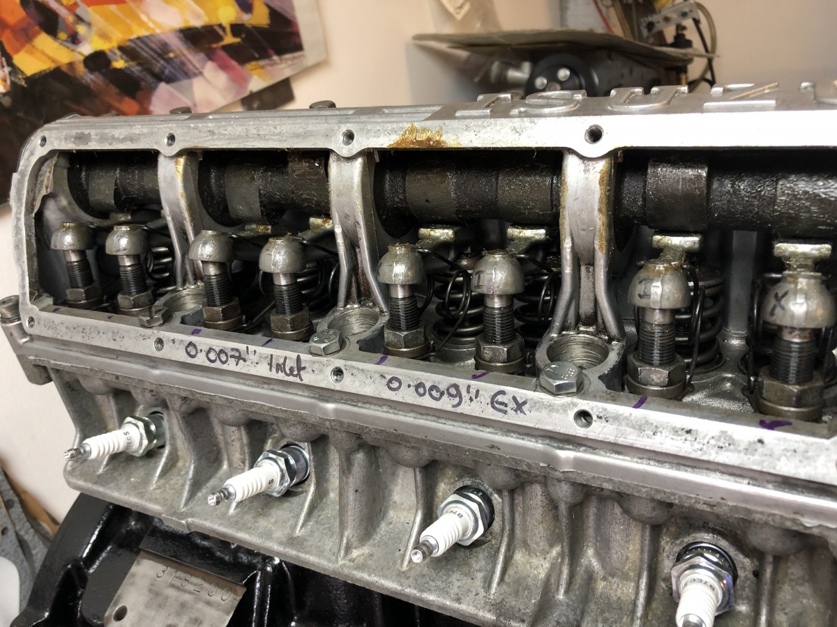

The clearances are tight aren't they?....don't forget if you're running anything other than a standard cam you might want to open them up a bit.
After two munched cams and much head scratching we opted for 0.23 ex and 0.18 in.....and it seems to be working pretty well.

Hi Mark, I'm no mechanic and to be honest, have never adjusted clearances my self. But the numbers above did seem 'tight'. Sorry to hear 2 cams paid the price.
