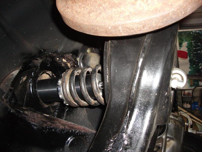

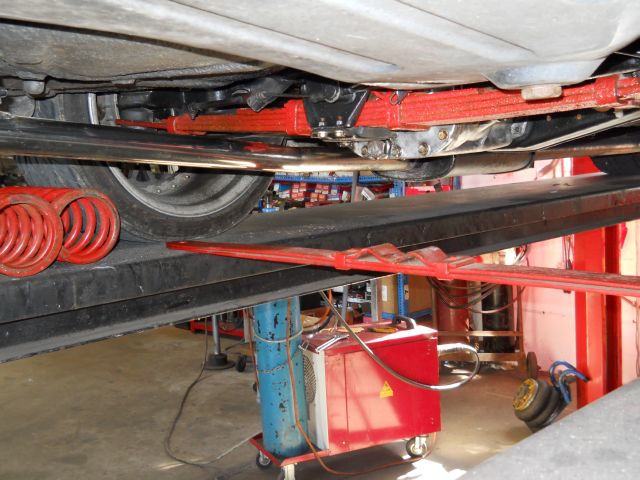

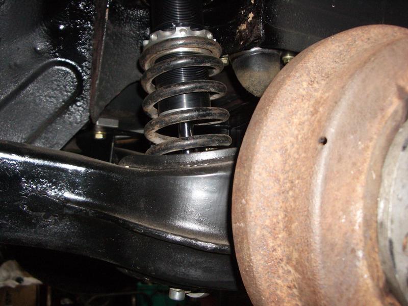

Sorry I've missed out on the earlier discussions, but it's all very interesting and thanks for your contributions. I've taken a few pics of our set up, I'm afraid they've not come out as well I hoped, but they may still be of interest.
You might have to put your screen onto its side for this one!
And this is a photo of the Scandanavian set up

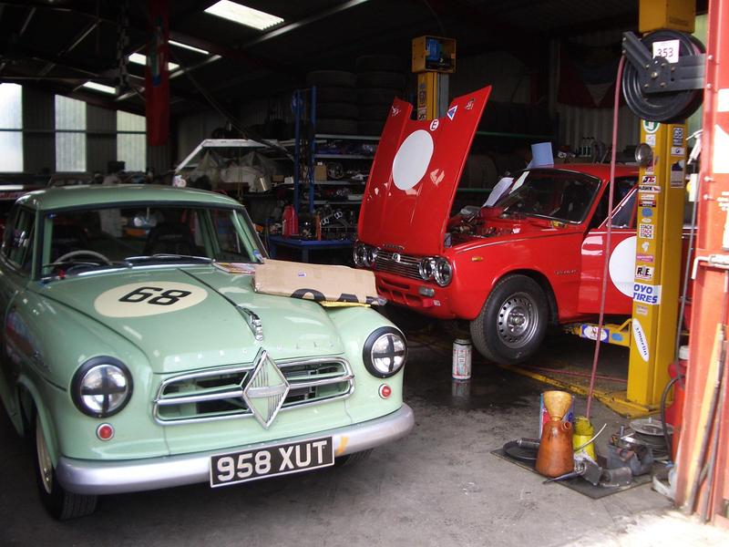

One of my reasons for not joining in on the more recent discussions is that we've suddenly come up against some problems with the engine......amongst other things, after the test we've ended up with two broken valve springs and a broken valve guide. Under the bonnet boys :roll:
And lastly, I like this one.....it's Rolie and his stablemate.....one of Techno Chris' earlier creations that ran at Goodwood last year.
