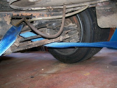

Hi Alistair, great work, keep going. Looking at the photo's of the rear transleaf spring it appears to be installed upside down, if my memory is correct to w plate should be to the top and locates with a rubber shaped the same, this may reduce the pos camber a little. Prior to me obtaining a factory competition transleaf, we use to have two, sometimes three transleaf springs clamped together, hard to describe though they started with the spring tensions oppisite each other and then clamped, then for a little more neg , we would place either another larger rubber between the leaf and the wishbone mount, or if this was too much, one of the smaller rubbers, these little adjustments are dependent on driving and or road conditions, if i get a chance I will post a photo of the factory rear transleaf, regards Geoff.

Would be great if you did have some pictures, I had a thought that it may be installed upside down when I was first looking at the camber issue.

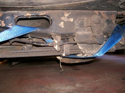

Hi Alistair, attached are photo's of the factory rear transverse spring, its a little grubby under at the moment, as you can see they have 4 leafs set at progressive lengths with the lower leafs ends curved slightley upwards, this set up also uses smaller diameter coils ( Isuzu racing ) unsure of their poundage with Isuzu racing shocks

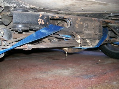

A couple more

The sedan only has the one leaf spring from the factory unless it's the race trim one.
