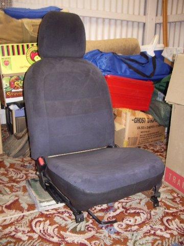

Into the third week of replacing the original (violet crumbled) seats in the GT. Got these seats cheaply from dismantlers Jepps Cross. They fit and siut, only problem is the runners and mounting points are offset and completely different from the originals. Soooo...
The measuring and drawing of adaptor plates. I got them back from the metal fabricators today and quickly learnt they had missenterpreted what I had told them in a 20 min conversation in detail. The opposing seatbrackets weren't a mirror image as requested and some angles were missenterpreted. Anyhow, a quick trip back to them and we can rebend and modify the existing brackets. :oops: not happy Jen but its all about perseverence. Meanwhile, back in the "bat cave" some pics of the empty GT (MT GT). Brad on the floor, the old seats (don't take the covers off, aagh, violet crumble all over the shed), the new seats (much like what i've seen of a Late model GT). Should have revised brackets next week. Wll put next pics up when installing.

Here are the seats to go in, sorry had to post again (poor "E" literacy skills)
