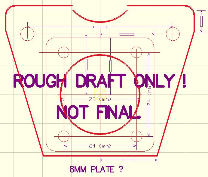

I have seen one fuzzy picture of this and i can't read the dimensions.
What are the bolt spacings on the drum brake stub axles.
Im trying to set up a 5 stud conversion.

I assume you want the dimensions of the 4 holes in the stub axle casting:-
pretty sure this is a drum braked stub axle. Actually, as far as I am aware, they are all the same anyway?
I drew this up yonks ago for a TP Magna caliper i think it was. But you should be able to get the dimensions of the bolts holes from it for the axle itself.
The 'square' section is 95mm wide by 100 high.

Many thanks Glenn, that's the one.
