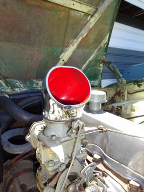

The early Bellett Nikki was bigger. Had bigger jets too.
The late Bellett one was rubbish. Small chokes, small jets.
Is all due to the cam they had.
If u want a Nikki, get a Gemini or Datsun one. You need a different air cleaner tho.
Donkey's is the early Nikki (and doesn't use an air cleaner :twisted: )

Mon Aug 24, 2015 7:32 am
Yeah same size neck as a Stromo.....
Nikki jets are interchangeable tho. U could always just bang some bigger ones in out of a Gemini or Datto.
