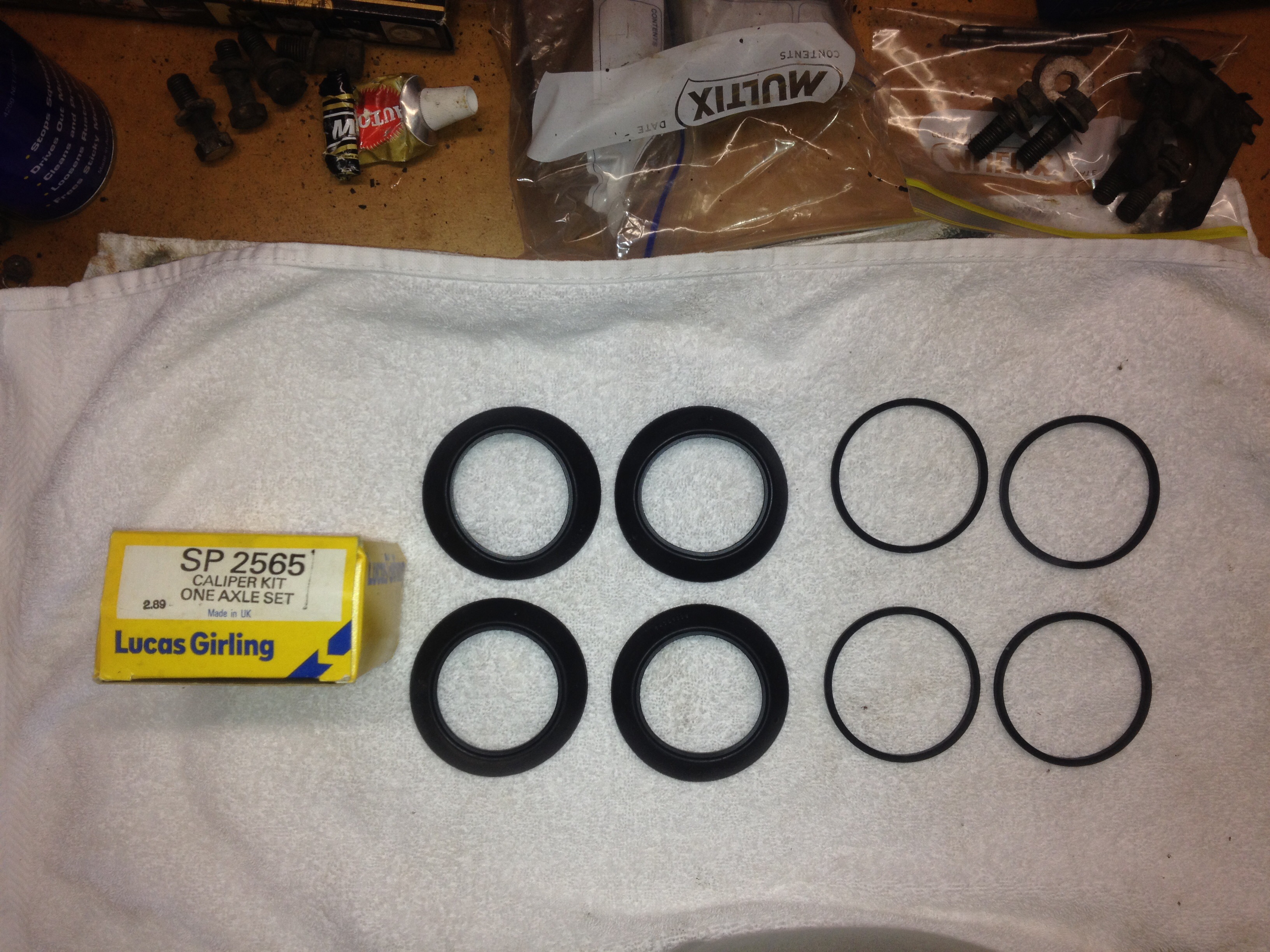

Well have some information
http://www.powertrackbrakes.co.uk/wcylinder.html
The front pistons are off the Jaguar 420G saloon built from 1966-1968... small run which makes then rare in itself
Calliper Rubber Kit : Girling SP2565
Brake Pads Bellett : DB704 (No longer available - save your backing plates and have them re-bonded)
J

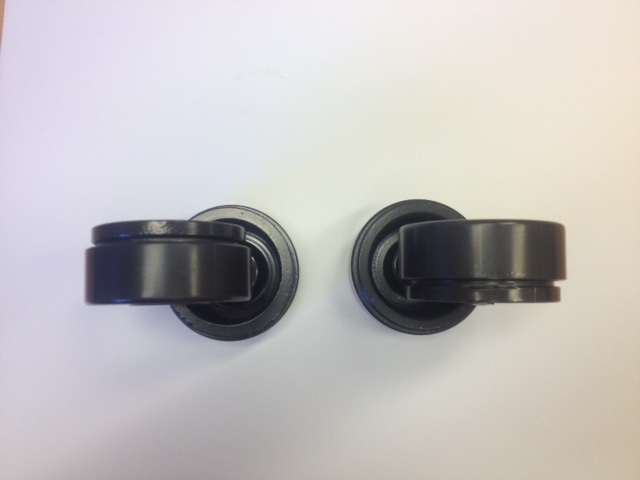

Just picked up the pistons from the Ceramic Coaters
3 are definitely useable, 4th touch and go as likely to 'seep' which may be OK on weekend driver but not daily driver so I will give it a go.......
Interim step to Sleeving if pitting minimal at about 1/3 cost........
J
